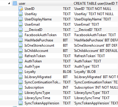

This is the 'user' table for the Kobo I just bought (firmware 4.7.10.413). Should anything be left alone to prevent messing up the device? Also, the fourth post in this thread states that one also needs to downgrade to firmware 1.9.16 in order for this hack to work. Is that true?
Originally Posted by rashkae View Post
The new firmware will not accept new books until it's registered.
