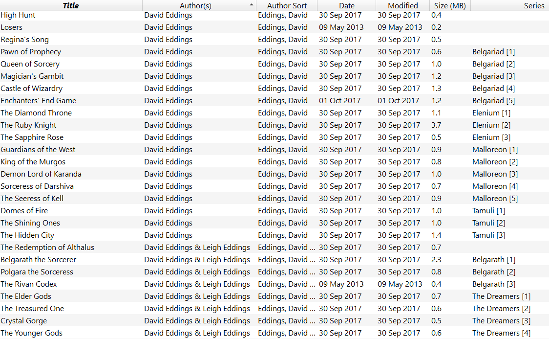

Odd. When I used the tweak I suggested on my computer, it seemed to work. I've attached an image of what I saw. Authors, then series, then title unless no series in which case title. Using your version gave me the same result. If I clicked on title => series => author, the result looked the same.
Name:	Screenshot 2024-05-07 174532.png
