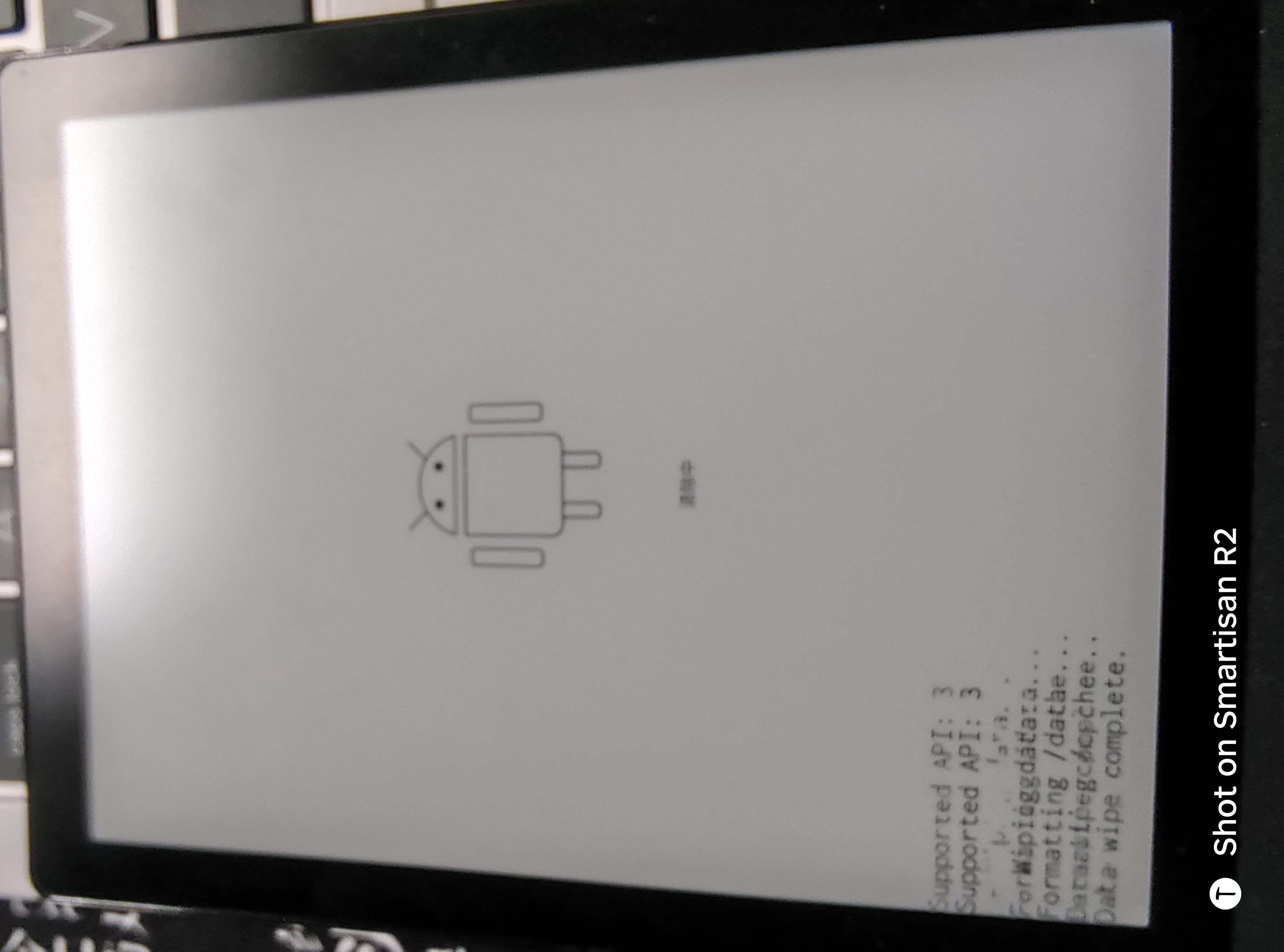

If you previously wiped data and nothing overwrote that command it will try to overwrite again.
What do you see when you reboot recovery? Do you have rooted ADB?
Don't tell me what you didn't see. Tell me what you did see.

I attach a photo taken after i adb reboot recovery in the original system after i flash the p9mod.

Originally Posted by f_coco View Post
Hi, Renate.
That's wacky Chinese stock recovery doing a factory reset of the device.
You may have flashed my recovery, but it's way gone now.
You need to learn about EDL.
You need to boot to something and
adb reboot edl
You need to go to my website, read about EDL and do everything there.
edl /lpoke3.bin
edl /g
edl /w /precovery p9mod
edl /w /pmisc misc-recovery
edl /z
Use your common sense with file names if I got them wrong.
When you get a white screen that's doing nothing, you have success.
Then do the "adb shell start autoupdate".
Finally, when things go clearly wrong, just stop.
File Type: prc misc-recovery.prc (512 Bytes, 909 views)

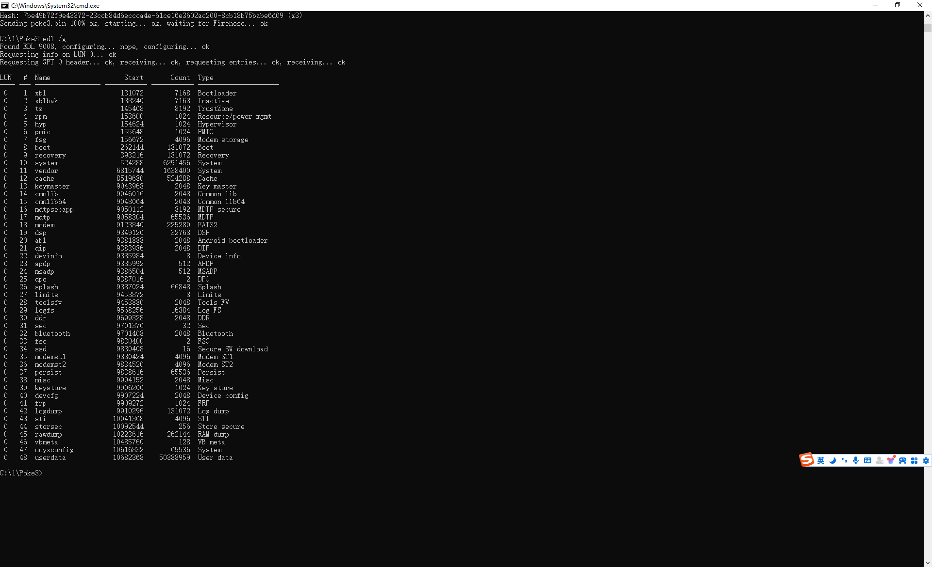

Hi, Renate.
Thanks for your help.
I can made it to the edl mode. i can see the partition tables.
Before i proceed to the next step, I just want to check with you is there a way i can backup all partitions? Just in case someting gose wrong.

If you've got 32 GB of space on your desktop just collecting dust, do this:
edl /r big_darn_file
