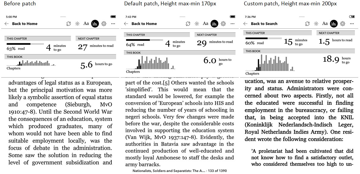

Has anyone ever posted pictures of what the result looks like when using the patch "Increase size of kepub chapter progress chart"? It sounds like a good idea, but I'm not sure how big the chart is going to get or whether the size can be adjusted further while still fitting on the screen.
Old 05-26-2024, 07:13 AM   #1121
hatuluang
Teluk Biru
hatuluang ought to be getting tired of karma fortunes by now.hatuluang ought to be getting tired of karma fortunes by now.hatuluang ought to be getting tired of karma fortunes by now.hatuluang ought to be getting tired of karma fortunes by now.hatuluang ought to be getting tired of karma fortunes by now.hatuluang ought to be getting tired of karma fortunes by now.hatuluang ought to be getting tired of karma fortunes by now.hatuluang ought to be getting tired of karma fortunes by now.hatuluang ought to be getting tired of karma fortunes by now.hatuluang ought to be getting tired of karma fortunes by now.hatuluang ought to be getting tired of karma fortunes by now.
hatuluang's Avatar
Posts: 166
Karma: 348662
Join Date: Jan 2023
Device: Kobo Clara 2E
Please find the screenshots (dragon),
Left: before patch
Middle: default patch, height max-min: 170px
Right: custom patch, height max-min: 200px
hatuluang is offline   Reply With Quote
Old 05-26-2024, 05:42 PM   #1122
Aleron Ives
Posts: 1,843
Karma: 17000000
Join Date: Sep 2022
Thank you!

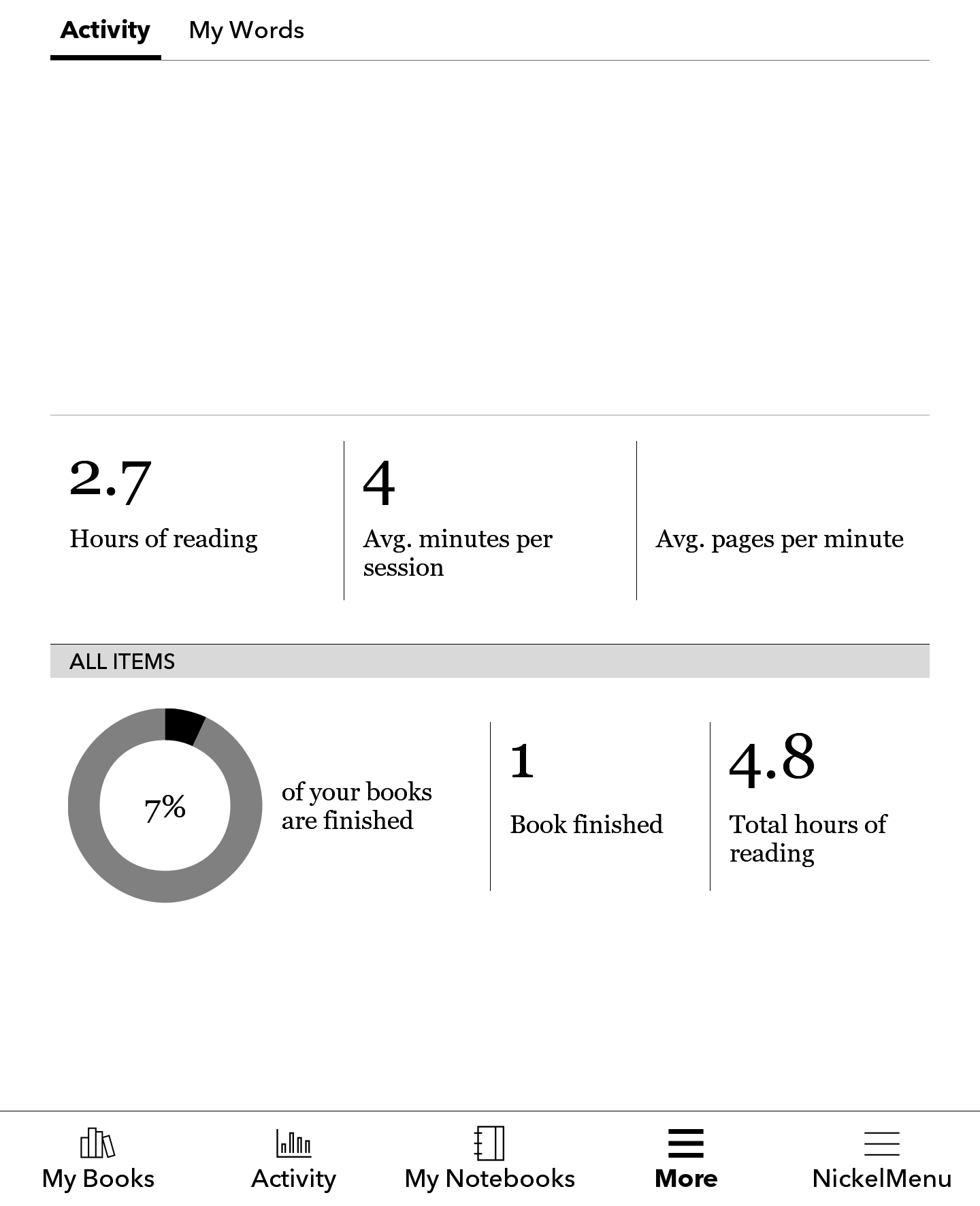

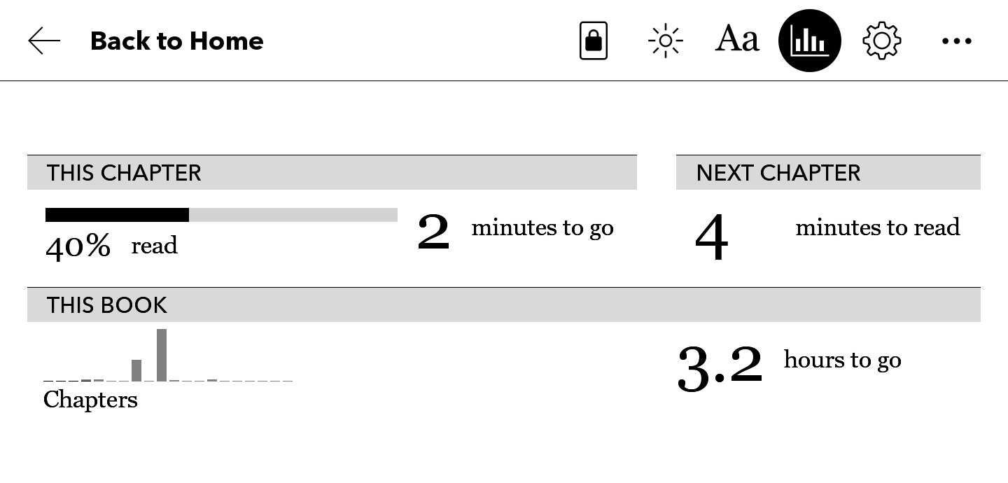

Patching out reading stats/activity completely
Hello, everyone.
I got a Kobo Sage a couple of days ago and have been doing some tweaks.
Is it currently possible to edit the top menu in the in-book reader?
Specifically, I wish to remove the button which displays the remaining time left in the chapter and book:
Also, on a related note, I'm on the side-loaded mode and want to know if it's possible to hide the "Activity" tab of the "Activity" section, while still keeping the "My Words" tab. If that's not possible, can the entire Activities section be removed?
I couldn't find any patch which covers these, and also tried with NickelMenu but it seems that only allows the creation of new items, but not the removal of built-in ones.
