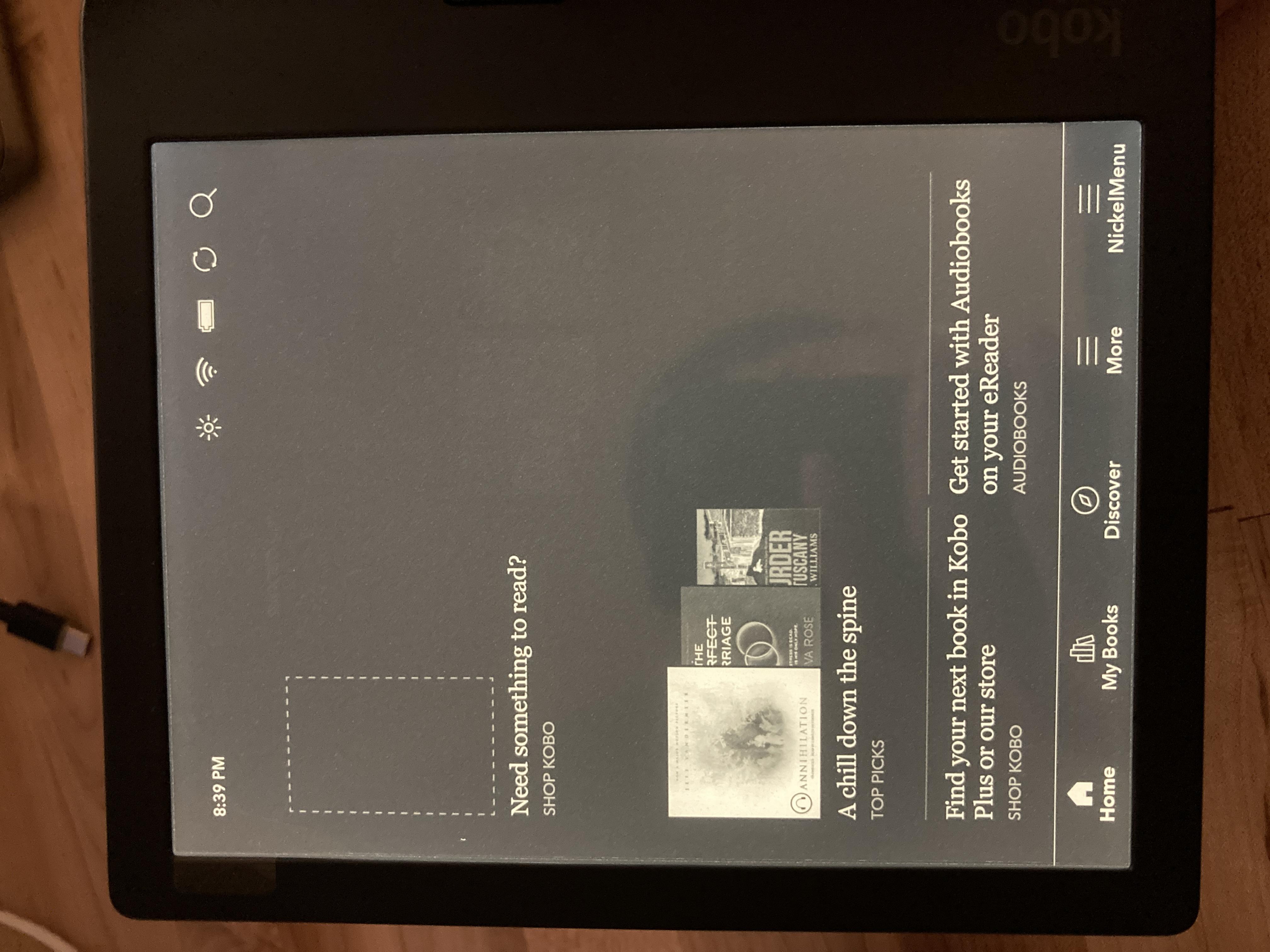

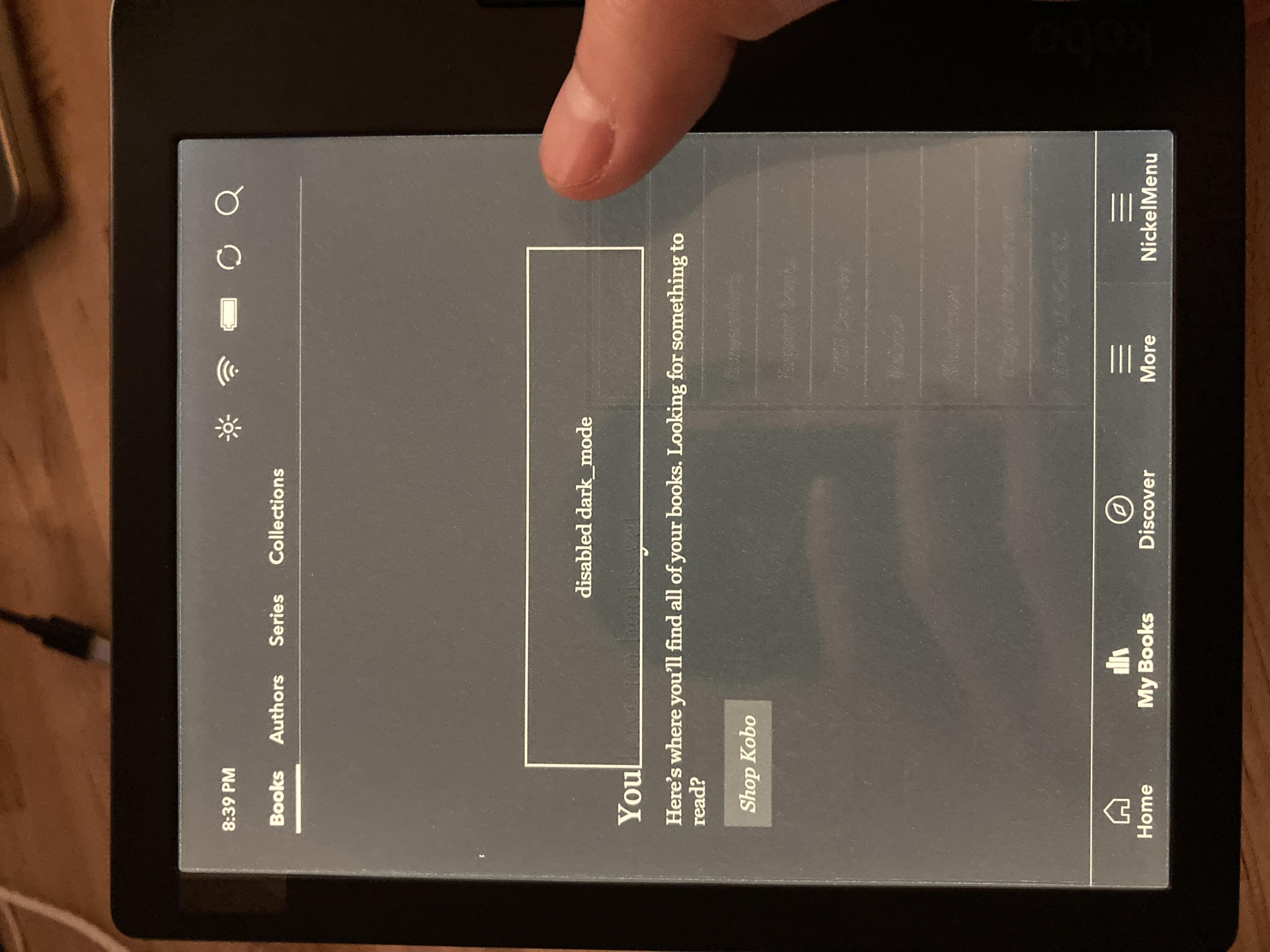

Originally Posted by h_nara View Post
After installing Kobo Uncaged, my Kobo Libra 2 are now in 'dark mode' regardless of the settings. Any ideas? I tried to see if anyone else experienced this before but didn't find anything.
Update: I found another thread where a user had the same problem and deleting InvertScreen=true in the eraeder.conf fixed the issue. I have no idea why installing kobo uncaged had this side effect though.
h_nara is offline   Reply With Quote
