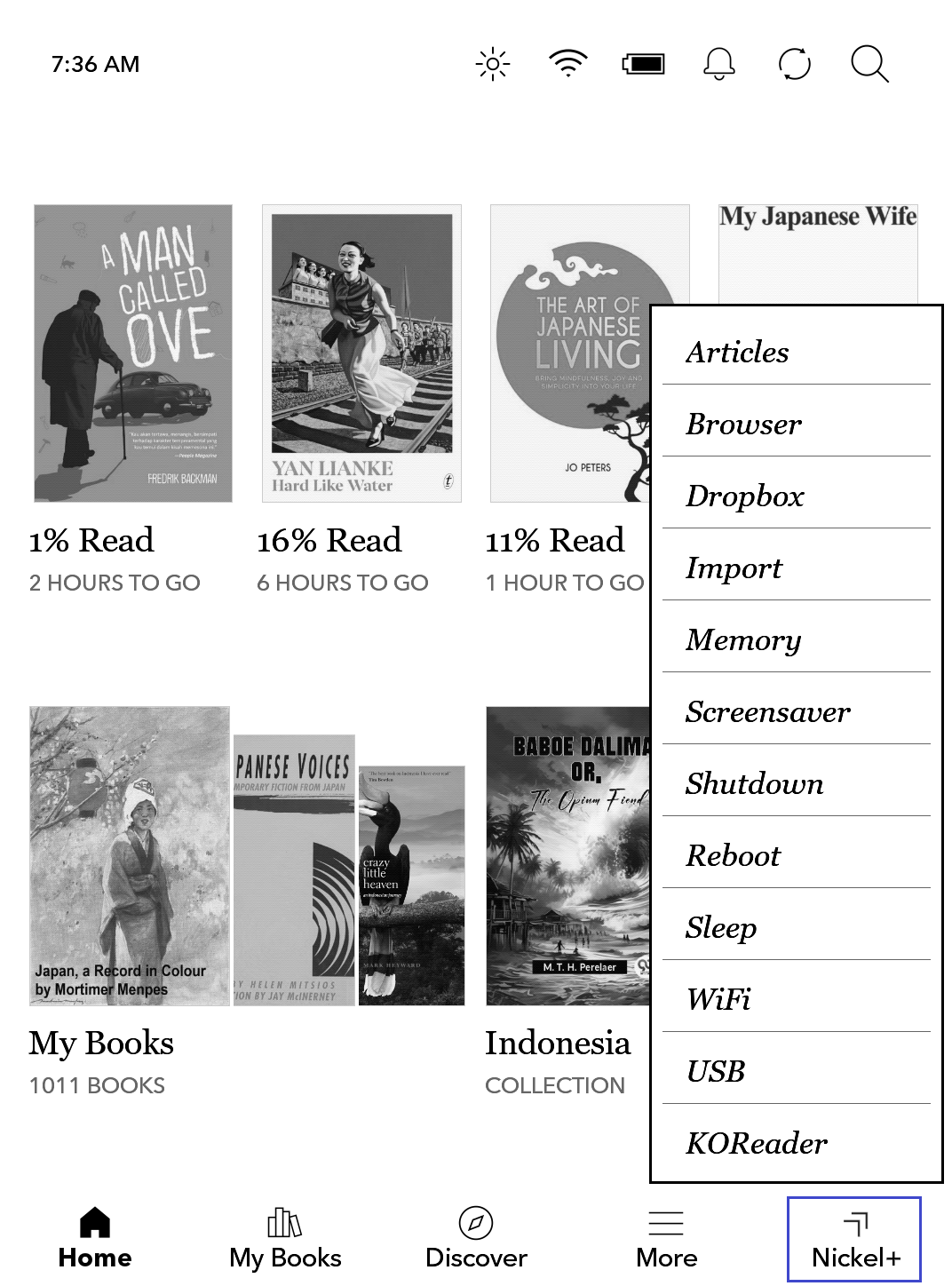

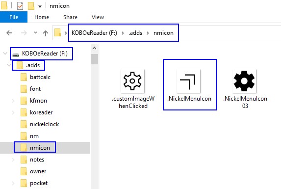

Originally Posted by lmfb13 View Post
Any ideas on why I'm unable to change the NickelMenu icon on my wife's Libra 2 but when I changed mine just the other day it worked fine?
Her Kobo is brand new and I just installed everything and brought over the same config file and png that I was using. Here's the lines I have that relate to the icon. I have a bunch of other stuff in the config file and everything works fine including the label, just the icon isn't showing up no matter what I try. I have the png in the root folder like it is on my ereader as well. I've tried moving it and adjusting the config file accordingly.
experimental :menu_main_15505_label :Shortcuts
experimental :menu_main_15505_icon :/mnt/onboard/shortcuts.png
experimental:menu_main_15505_label:Nickel+
experimental:menu_main_15505_icon:/mnt/onboard/.adds/nmicon/.NickelMenuIcon.png

Originally Posted by hatuluang View Post
Right now I have it in the root directory. I tried putting it in the same folder that you have and changed my config file to match (tried both with and without the file being hidden) but it still just shows the three horizontal lines as the icon, even after a reboot
Make sure the size of the Nickelmenu icon (bit depth 32) is following your Kobo model:
24 x 24 pixels, Trilogy: Touch A/B/C, Mini, Touch 2
30 x 30 pixels, Phoenix: Aura, Aura Edition 2, Glo, Nia
42 x 42 pixels, Dragon: Aura HD, Aura H2O, Aura H2O Edition 2, Glo HD, Clara HD, Elipsa, Libra 2
50 x 50 pixels, Storm:Libra H2O
56 x 56 pixels, Daylight: Aura ONE, Forma, Sage, Elipsa, Elipsa2E
hatuluang is offline   Reply With Quote
