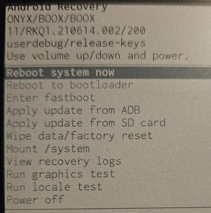

Since you have the decrypted update.zip, have you tried:
fastboot boot recovery.img
Does this run normally? Does it give you more options?
Old 04-21-2024, 03:04 PM   #65
Pentam
Pentam began at the beginning.
Posts: 54
Join Date: Jul 2023
Device: Boox Tab Mini C
Yes, this boots normally to recovery. Recovery options are still the same (see attached image). ADB still unauthorized.

Old 04-21-2024, 04:54 PM   #66
Renate
Onyx-maniac
Posts: 4,554
Karma: 22077803
I can probably patch recovery for ADB.
My internet here is slow, so could you post just the recovery somewhere for me.
I think that this is using the new updater and I'm not so experienced with that.
Does this have an update-binary of ~280 kB or so in META-INF?
Please post that too.
Old 04-22-2024, 05:34 AM   #67
Wolf-HRB
Wolf-HRB began at the beginning.
Posts: 37
Karma: 18
Join Date: Feb 2022
Device: PW3, PW4 and PW5 Signature Edition
please try the following steps:
1. remove 2 commands in my bat file:
fastboot erase userdata
fastboot -w
2. after flash, use following command:
fastboot reboot recovery
3. perform factory reset process in recovery
4. reboot
try this and see how it goes
Wolf-HRB is offline   Reply With Quote
Old 04-22-2024, 12:06 PM   #68
Pentam
Posts: 54
Join Date: Jul 2023
Here is the link to the recovery.img.
META-INF just contains 2 files: "metadata" and "otacert"
No other file of ~280 kB size. Sorry.
Pentam is offline   Reply With Quote

Old 04-22-2024, 12:22 PM   #70
Renate
Onyx-maniac
Posts: 4,554
Karma: 22077803
Thanks. It's 96 MB, did you pull this off the device? Is it the latest from the update?
I'm at 20% downloaded.
There's probably a count for failed reboots.
Old 04-22-2024, 12:25 PM   #71
Pentam
Posts: 54
Join Date: Jul 2023
Yes. 96 MB. That's straight from the update.upx.
Yeah, would make sense...

Usually, if the option is available, installing a new update semi-manually is easier than EDL-ing individual partitions.
Especially since super has become multiple files on some devices.
You can try adb sideload (I never have).
If that doesn't work, we can try the flash drive method.
That works with update-binary, but I've never tried with this new update engine.
update_engine_client --help
Android Update Engine Client
  --allocate  (Given payload metadata, allocate space.)  type: bool  default: false
  --cancel  (Cancel the ongoing update and exit.)  type: bool  default: false
  --follow  (Follow status update changes until a final state is reached. Exit status is 0 if the update succeeded, and 1 otherwise.)  type: bool  default: false
  --headers  (A list of key-value pairs, one element of the list per line. Used when --update or --allocate is passed.)  type: string  default: ""
  --help  (Show this help message)  type: bool  default: false
  --merge  (Wait for previous update to merge. Only available after rebooting to new slot.)  type: bool  default: false
  --metadata  (The path to the update payload metadata. Used when --verify or --allocate is passed.)  type: string  default: "/data/ota_package/metadata"
  --offset  (The offset in the payload where the CrAU update starts. Used when --update is passed.)  type: int64  default: 0
  --payload  (The URI to the update payload to use.)  type: string  default: "http://127.0.0.1:8080/payload"
  --reset_status  (Reset an already applied update and exit.)  type: bool  default: false
  --resume  (Resume a suspended update.)  type: bool  default: false
  --size  (The size of the CrAU part of the payload. If 0 is passed, it will be autodetected. Used when --update is passed.)  type: int64  default: 0
  --suspend  (Suspend an ongoing update and exit.)  type: bool  default: false
  --update  (Start a new update, if no update in progress.)  type: bool  default: false
  --verify  (Given payload metadata, verify if the payload is applicable.)  type: bool  default: false
Old 04-24-2024, 10:11 AM   #75
Renate
Onyx-maniac
Posts: 4,554
Karma: 22077803
Also, I believe that this is an SDM662, so we have the Firehose loader for that.
