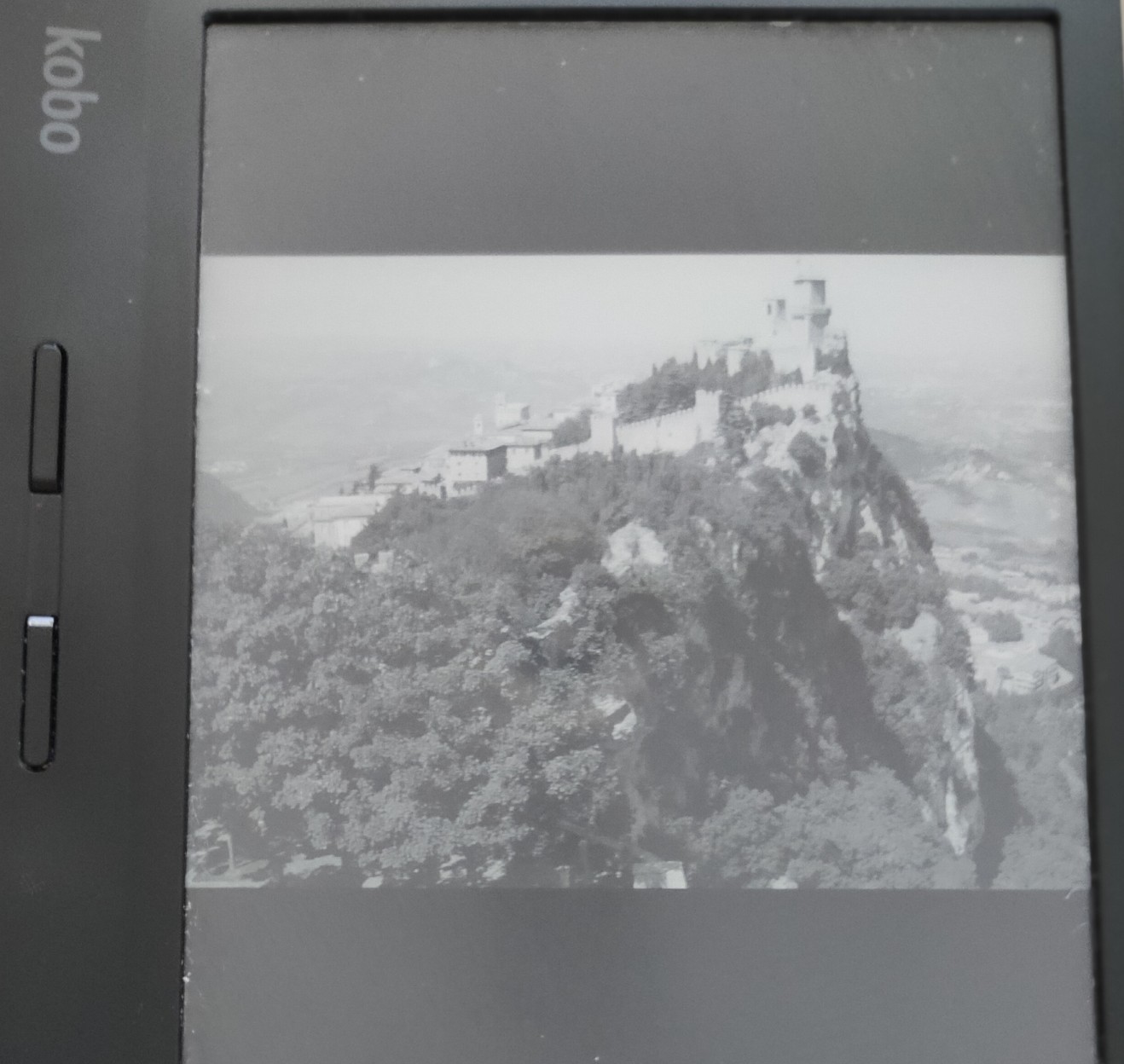

Thanks again - PERFECT result! As a bonus, the info panel is much less intrusive on my chosen screensaver than it was on the book covers.
