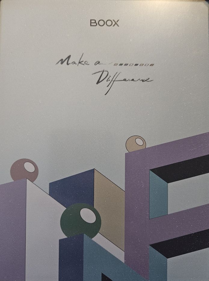

Originally Posted by Wolf-HRB View Post
Thank you very much for the upload and creation of the BAT-file.
I got an error during the execution:
Erasing 'userdata'                                 OKAY [  0.285s]
CreateProcess failed: The system cannot find the file specified. (2)
fastboot: error: Cannot generate image for userdata
******** Did you mean to fastboot format this ext4 partition?
as response to
fastboot.exe -w
fastboot.exe erase userdata
After the reboot command it bootloops a few times (3?) and then goes into fastboot mode again.
Afterwards I tried switching active slots (B->A). Resulted in getting stuck in EDL mode.
Switched back active slot to B. After reboot the device rebooted twice and then booted past the ONYX Logo and into the BOOX boot animation.
However, the animation has now continued for more than 20 minutes and nothing is happening.
I got as far as the animation twice before I started the thread. But the animation froze in both cases after the third dot got colored. So we are a bit further than before...
Any ideas what else to try?

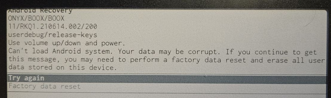

Hmmmm, that's weird. I tested what I packed before I upload it. However, DO NOT TRY to change active slot manually, since this device uses VAB (ONLY ONE SLOT IN SUPER PARTITION HAS FULL OS), therefore, change active slot may cause some unexpected situations. Secondly, after you flash the things I provide, go to recovery and manually perform factory reset, see what happens then. Thirdly, if everything still not work, I will provide you more partitions to let you flash in and see how it goes.
Well... changing the active slot was the only way to get it to do anything else than rebooting to fastboot.
I tried flashing, rebooting to recovery, factory reset and rebooting. Result: three boot loops up to boot animation that freezes at the first dot, then reboot to fastboot.
After rebooting a couple of times yesterday, I got the same error that initially started the whole problem (see attached image).
Pentam is offline   Reply With Quote
Old 04-21-2024, 08:39 AM   #60
Wolf-HRB
Wolf-HRB began at the beginning.
Posts: 37
Karma: 18
Join Date: Feb 2022
Device: PW3, PW4 and PW5 Signature Edition
then choose do factory reset. swipe the screen to select, then press power button to confirm
