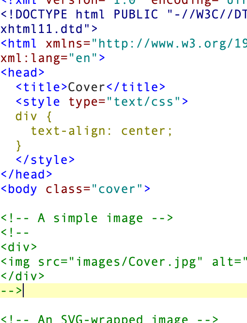

Okay, after some more experimenting, I now have a way to double the insertion point text cursor width from the default 1 pixel wide to 2 pixels wide which helps to make it easier to detect. This should work in all FindReplace and all QLineEdits too.
Remember the insertion point cursor has to fit between adjacent characters. So the wider it gets the worse it looks when fonts with kerning and tight letter spacing are employed. So going more than 2 pixels is not recommended.
It is reasonably painless and seems to work requiring only a few small changes in CodeViewEditor.cpp and main.cpp.
So I am thinking of creating a Sigil Main UI Preference Appearance to enable or disable it. Changing this setting would require a Sigil restart since it involves changing the main application style on the fly.
So something along the lines of:
    [] Make text cursor insertion point more visible
I would like to know if our users would find this useful or not before fighting with the Sigil Preferences again (or begging DiapDealer to do it!).
I have attached two screen shots. Since they are static, no blinking involved. But look at the end of the xhtml comment at the line in yellow to compare the text cursors before and after.
Note: these screencaps appear much larger on the screen when I open them here on Mobileread than the actual on my display so both appear reasonably easy to see but that is not quite how it seems to me. Not sure how to show the difference otherwise.

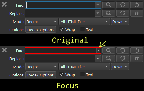

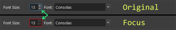

My two cents on the option "Highlight Widgets with Focus" (applies to Windows, possibly others).
The simple QSS for showing focus has a certain unpleasant side-effect, which applies primarily to the two widgets: QSpinBox and QComboBox.
Well, the focus overwrites the default 'Fusion' style and ruins the aesthetics of these controls.
The problem has been known for years, but I have not found a simple solution.
Link
I am not in favor of removing this new option if users find it useful, but it is worth adding a note in the documentation that the aesthetics of the UI will suffer with this option enabled. The Accessibility tab is also a good idea.

The FindReplace arrow just shrunk a bit to allow the border. But the spinbox arrows change seems really bad.
I will check things on macOS to see what happens there.
KevinH is online now   Reply With Quote

@BeckyEbook,
Couldn't we restrict that :focus qss to specific classes leaving out QComboBox and QSpinbox since one highlights the text before the up/down buttons, and the other has a blinking cursor or highlight when it has focus?

The opposite problem exists in macOS, as the FindReplace pulldowns look horrible and the QSpinbox is just slightly smaller.
Interesting ...
