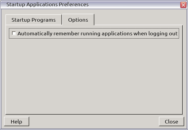

On Mint and many other distros there is Startup Applications Preferences under Personal in Control Center
Name:	Screenshot at 2024-04-06 19-59-40.png
Tick the box and log out with only Calibre running.
Then reboot and log in. If calibre doesn't correctly automatically load then it certainly won't from systemd.
If it does work, and it should, then the problem is something else.
However, what is the purpose of launching Calibre without logging in?
Attachment 207391
All I was seeking to do was have Calibre auto-start on reboot.
It starts automatically with me as the user, no PW, so no explicit "logging in".
Thanks for your engagement - I'll try --detach and see if that makes the cronjob possible.
