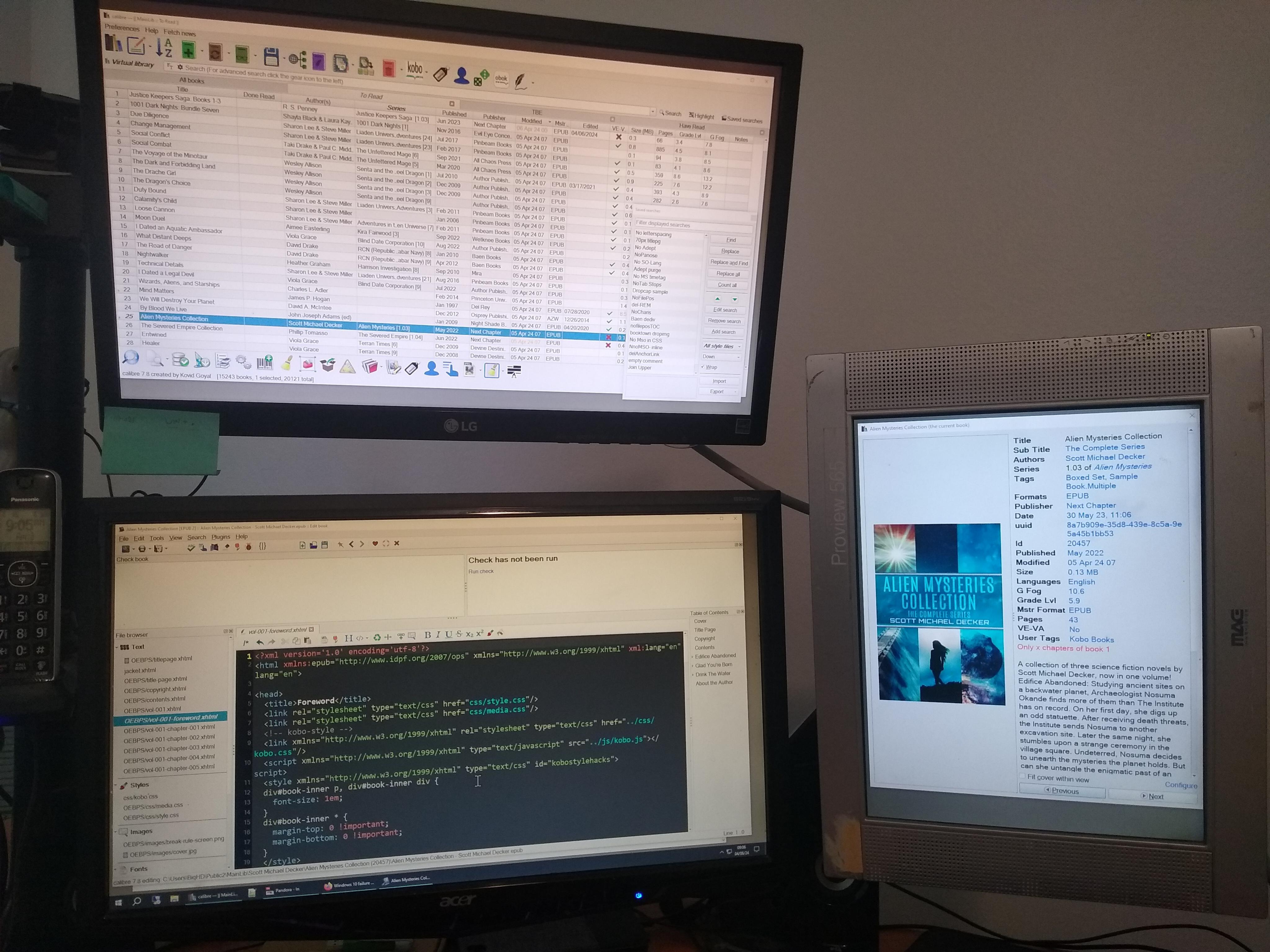

I am running a really old (almost 20, VGA) monitor on an ancient Aluratek USB adapter for my 'preview' screen. (W10 ) . The driver for a 'Trigger 1+'
I did find I could not have a more modern USB Video connected at the same time. That fail was at the Windows level)
