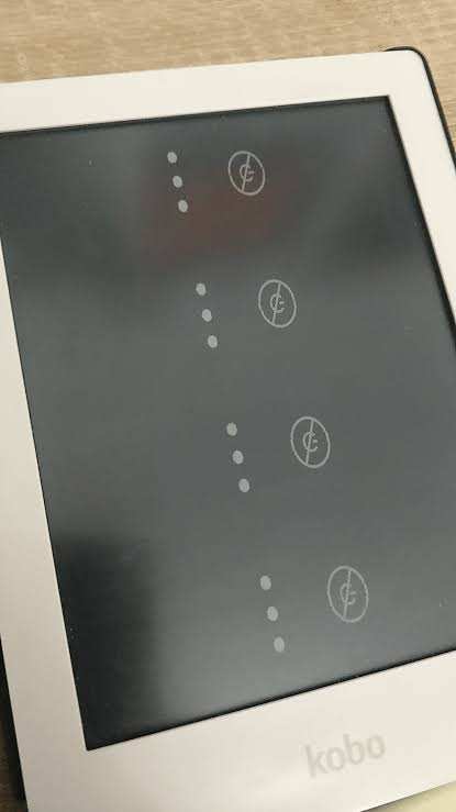

Hello my dudes. I hope all is well.
I had to change the device's internal micro SD and replaced it with a Kingston 8GB. So I uploaded an image of firmware version 2.4 kindly provided by a forum user. So far so good. The problem happened when I tried to update the firmware. I tested all the newer ones manually and the only one that the device accepted was version 4.26 (the others bricked the device needing to do a hard reset). Does anyone have an idea what could be happening? Thanks.

Explain "bricked".

Explain "bricked".
sorry, english isn’t my native language. bricked as a vertical line with three ‘C-’ symbols. something like this

Until someone more knowledgeable comes along...
That looks like a 90degree rotation telling you not to cycle power while it is doing something (repeated vertically). Are you sure you have the right firmware for your model?

Device: Kobo Aura HD
I got all firmwares from this website and the 4.26 version is working as intended, but honestly I don’t know if it’s 100%. what site you guys use?!
That's the correct site and it gets FW from Kobo server(s).
I've seen that image and sometimes a frightening long upgrade, but it came OK. Make sure well charged and cable USB disconnected.
Interesting! I gave up after an hour. I will try to leave it overnight and I’ll share the results tomorrow!
An hour sounds broken. Less than 5 minutes. Try a fresh download as the Kobo servers were poor for a while.
I think I had a new version than that on the Kobo Aura H2O original.

Quick update: So I tried to leave it updating overnight and it didn’t work :/
