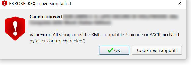

First thanx for Your indispensable plugin!
Plz let me to get rid of this error:
Error('All strings must be XML compatible: Unicode or ASCII, no NULL bytes or control characters')
I tried all possible preferences flaggings and export formats...
Is there any way to make finish the export, even if with errors?
Thanx in advance

Deckard is offline   Reply With Quote
There is something unexpected in the book you are trying to convert that the KFX Input plugin does not handle properly. In order to correct the problem I will need some more information.
What is the name and ASIN (10 character ID starting with "B") of the book you are trying to convert?
Please create a debug log of the failure. To do that click the calibre Preferences drop-down menu and choose "Restart in debug mode". After calibre restarts perform the steps that result in the error dialog and then close calibre. A log file will appear which you can copy and paste into a post here on MobileRead.
You can try selecting the option "Allow conversion to complete even if errors are detected" in the KFX Input tab of the conversion dialog. However, I doubt that will work in this particular case.
Here's the ASIN code: B0CH2B1KZH
I was able to locate the cause of problem. That book contains incorrect formatting (control characters in URLs) which is causing the plugin to fail. I will release a new version of KFX Input sometime in the next few days that will be able to convert that book to EPUB.
However you should be aware that since that particular book uses fixed layout you will get superior results if you convert it to PDF instead of EPUB. See the section "From KFX" toolbar action in the first post of this thread for information on how to do that.

Version 2.10.0 - 31 Mar 2024
Eliminate unnecessary div elements occasionally produced in HTML output.
Handle styles in ruby text. (Fixes "ruby_content xxx 1 has extra data")
Handle unexpected control characters in URLs. (Fixes "ValueError: All strings must be XML compatible: Unicode or ASCII, no NULL bytes or control characters")

Tested! It works great PDF and EPUB!
