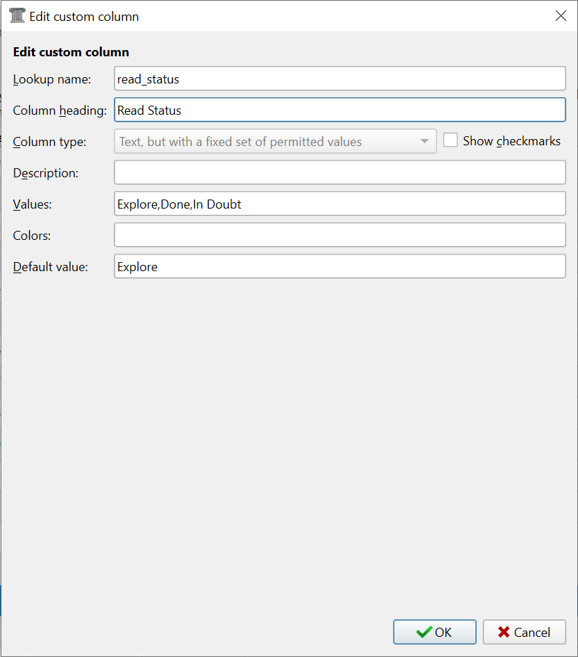

So, - life goes on...
- my custom column of logical 'yes/no' type ('To read' / 'Done read') doesn't seem to be universal enough
- now I need to have 'in-between' attribute in addition
- something like 'In doubt'
- how can I make appropriate custom column instead of the following
Maybe something like this:
Attachment 207185
thank you
- since VL with 'Read' value contains books with both 'Read' and 'Not Read' attributes - I slightly modified attributes to avoid such interference
Name:	calibre mine custom column 2024-03-27 112459.png
