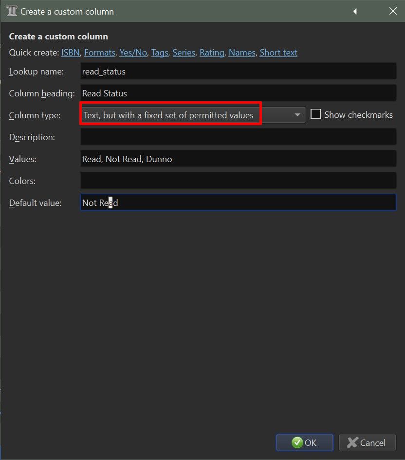

Originally Posted by baursak View Post
- how can I make appropriate custom column instead of the following
Maybe something like this:
Attachment 207185
thank you
- since VL with 'Read' value contains books with both 'Read' and 'Not Read' attributes - I slightly modified attributes to avoid such interference
Name:	calibre mine custom column 2024-03-27 112459.png
