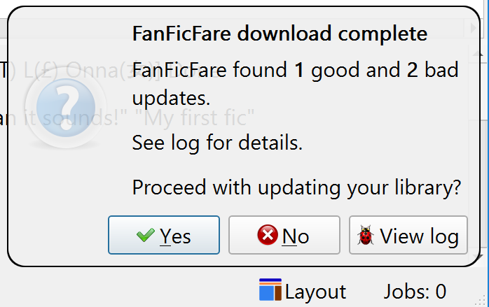

Originally Posted by bigwoof View Post
The latest test version? I am using that. all that appears to do is move the modals to the end of the task when the report comes out. that still stops any other tasks running.
Am I missing another version that turns this off?
If you are talking about the "Proceed with updating your library?" dialog, that is something Calibre requires (or at least strongly suggests) for plugins updating metadata. It's not modal, you can do other stuff before telling it Yes/No.
Otherwise, I don't think you have latest test version of FFF.

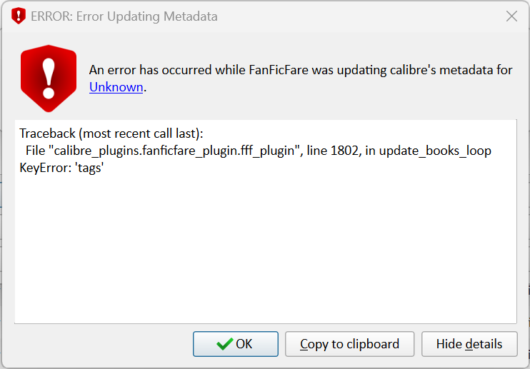

Old 03-10-2024, 10:20 PM   #9363
I'm clearly not explaining it well enough.. apologies!!
where are these errors coming from and how do I turn them off? they appear after clicking yes on the box you posted a picture off.
Thanks

New Test Version Posted
2023-03-10
- adapter_deviantartcom: Add another way to remove comments section.
- Don't try to set imap tags before checking for 'good' update.
That was a previously masked error related to adding tags specifically for IMAP downloads.
I won't be hugely surprised if more issues like this come to light.
In future, posting the error message helps considerably with troubleshooting.
2023-03-10
Thanks! I wanted to wait till I got an error before posting (to confirm that it worked) but no errors yet.. will observe over the rest of the week.
*UPDATE* and an error triggered right after I posted this (one of those annoying chrome cache misses). no more popups! Thanks!
