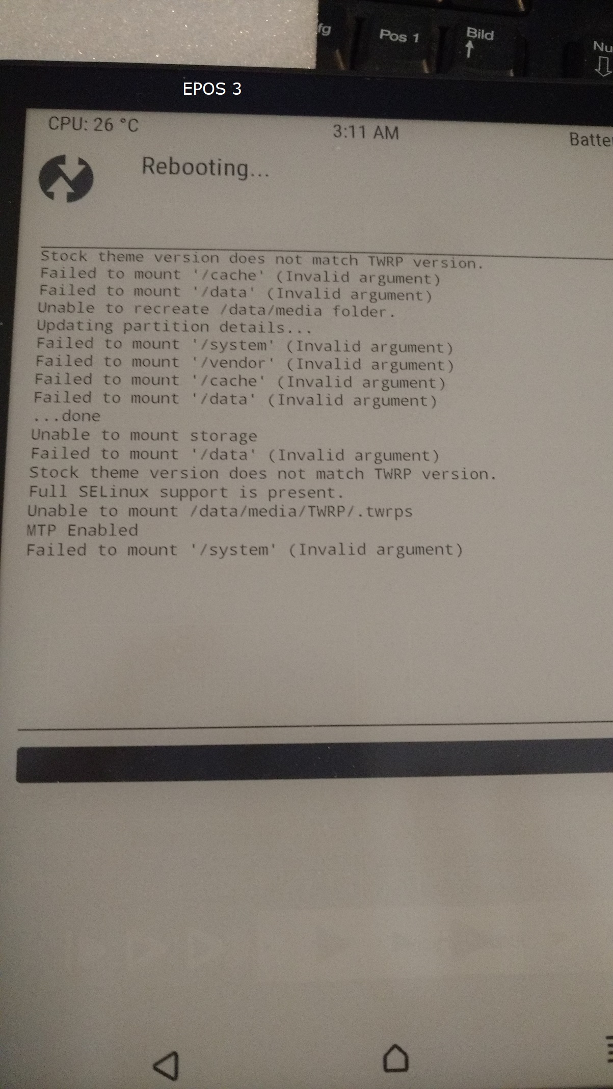

@iscilyas
Thank you very much for your effort!!!
I checked Vision 6 briefly, all functions seem to work.
It's the same with the Shine 4, except the screen is rotated 180 degrees.
On Epos 3 it unfortunately works with errors, roughly the same as TWRP from Nook Glowlight 4 on Vision 6.
If you want to customize TWRP for Epos 3, I would be very grateful.
I can provide Epos 3 mmcblk0.img or sections separately.
Thank you again for your work!

hey @waldy.. thanks for your comment and i'm glad someone is using it
i'm not sure what you mean with the "screen is rotated 180 degrees" but i'll take a look at that.
as for the Epos 3, it's probably because the partitions are named/numbered differently. it looks like you've managed to boot the kernel fine so it's probably going to be as simple as fixing up recovery.fstab
for starters, can you boot into twrp (from the vision6) and do something like:
adb shell find /dev/block > epos3-blocklist.txt
and send me the file epos3-blocklist.txt that it generates? then i'll send you an updated recovery.fstab that should work on the Epos 3.
iscilyas is offline   Reply With Quote

Originally Posted by Waldy View Post
I'm not sure I did the right thing
epos3-blocklist.txt
Maybe you need this too?
epos3-getprop.txt
hey thanks! yeah i would have eventually needed the getprop output as well
i'm just going on a hunch here, but am i right in assuming the blocklist you sent is from regular android boot, not (tolino vision 6) twrp? can you double check? i want the blocklist as seen by twrp (i was expecting something more like /dev/block/platform/soc/xxx/by-name/yyy instead of /dev/block/by-name/yyy)
Yes, my mistake.
I returned to stock recovery.
Here from under twrp:

Question
Yes, my mistake.
hey thanks for the block list.
it looks like the same disk layout as on the nook glowlight 4 (the one ported by @Ryogo-X)... that's odd. what happens with TWRP for Nook Glowlight 4 if you put it on the Epos 3? Doesn't boot at all? Maybe different kernels then...
anyway, if you send me the stock recovery image for Epos 3 (i'm assuming it's pretty much identical to that on the Vision 6, but let's play it safe) i'll build TWRP for it and send it to you for testing.
also if you give me the recovery (and getprop output) for the Shine 4 i'll see if i can't make it right-side-up..
and last but not least, if you can give me the usb vendorid/productid as reported by both of these devices i'll try to make that do the right thing too...
PS: i'm on a metered mobile internet thing so i didn't want to download those video/twrp links you sent earlier... is that the same twrp i built or did someone else do it too?
