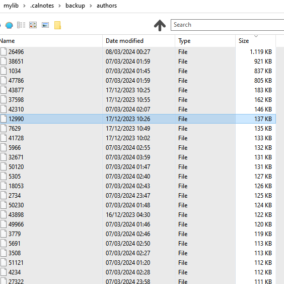

I notice the files below under .calnotes - backup:
Name:	MWSnap 2024-03-08, 01_28_28.png
Those are very easy to edit in bulk, by just loading them on a text editor and doing the Search and Replace on all open documents... If I could rebuild the database with these modified files...
Old 03-08-2024, 12:35 AM   #12
Posts: 46,057
Karma: 29579868
Those are backups, I dont recall in what circumstances exactly they are used, but you can try corrupting the notes.db file or deleting it and see if they get restored. Make proper backups before doing that of course.
