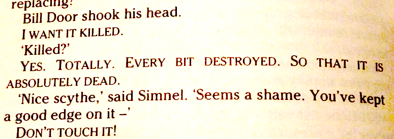

Same publisher and same author and same series. A 1990s edition
Seems to later change how Death speaks. From Reaper Man.
Attachment 206372
Death speaks the same way in the eBooks.
Makes sense as all the ebooks are about two decades later than the style change in paper printed series.
