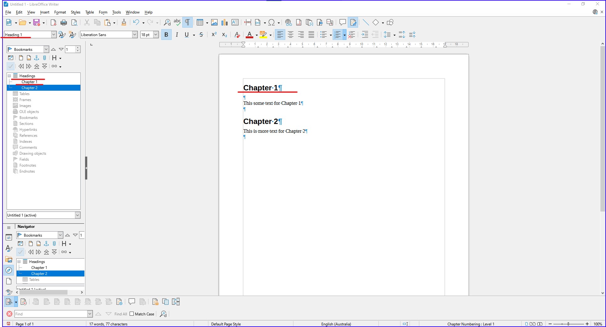

As for LO, check the image for my setup. I haven't heard of writer2epub. I just use the "Export as > Export as epub" option in LO Writer.

I create it in the Calibre editor.
Once you export from LO, the epub needs a bit of work, tidying up the tags, then I create the TOC once completed.
