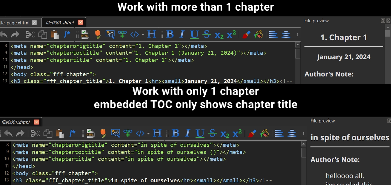

You can set add_chapter_numbers:toconly or customize chapter beginning HTML to use ${origchapter} instead of ${chapter} but that's about it.
Good enough for me so far. I'll know eventually if these settings still work well when a fic updates. I don't have the separate TOC page enabled so the "title ()" doesn't matter to me.
mark_new_chapters:latestonly
chapter_title_def_pattern:${title}
chapter_title_add_pattern:${title} (${date})
chapter_title_new_pattern:${title} (${date}) | NEW
chapter_title_addnew_pattern:${title} (${date}) | NEW
