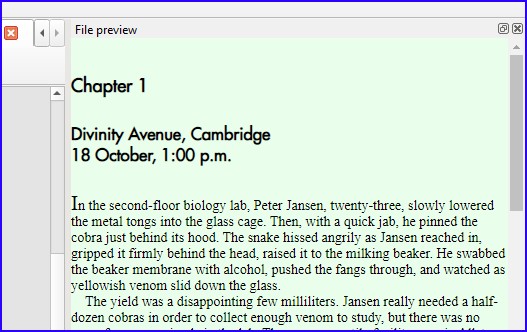

Ummm. Not true. I exclusively use ePub 2 as I haven’t gotten around to learning ePub3 yet.
Yes, I can, and do. I’ll take a screen shot and post it when I get home.
Edit:
Looks like you changed your comment while I was writing mine . You had said that code was only good for ePub3, which is not true. We’ve had this discussion before where you think pseudo-selectors are only ePub3, they are not.
Also, here is a screenshot from my phone. I used the above code, ePub2, and have a large first letter, small-caps for the first line - all with no spans or forced uppercase.
On a Kobo that code will not work if reading the eBook as an ePub. It will work if you have the span. RMSDK will not render it unless you get to a late enough version and nobody with a Kobo has a late enough version. Sure will will work as KePup. But not everybody reads KePub.

Location: Australia
Originally Posted by paperwhite13 View Post
There is one thing I was wondering about - new chapter pages, which are styled like this:
1.
Chapter Title
2.
Chapter Title
Saying I want to keep the number and the dot, which are styled differently (in terms of size, margins and font type) than the Chapter Title, how should that be tagged semantically? Should it also be an <h1 class="chapter-number"> with different properties? Before that, I thought about making it <h4>
I also use the method mentioned by others in the previous few posts...
PHP Code:
  <h3>Chapter 1</h3>
class="chapterh3">Divinity AvenueCambridge<br/>18 October1:00 p.m.</p
Which is then styled in the css as...
PHP Code:
h3 {
displayblock;
font-size1.3em;
font-weightbold;
font-stylenormal;
font-family"Futura Std Medium"sans-serif;
margin-top2em;
margin-bottom0;
text-indent0;
text-alignleft;
/*  text-transform: uppercase;
  text-decoration: underline;*/
chapterh3 {
displayblock;
font-size1.2em;
font-weightbold;
font-stylenormal;
margin-top1.5em;
margin-bottom0;
margin-right0;
text-alignleft;
text-indent0;
/*text-transform: uppercase;*/
  /*text-decoration: underline;*/
Which then looks like the below image (for the current book I am reading)
Sometimes I will use the title tag to incorporate the chapter name with the chapter number in the TOC, but I didn't think it was necessary in this case, plus it would be too long for the TOC and make it wrap.
And the styling is easy to change with each book.
(note the enlarged first letter )
