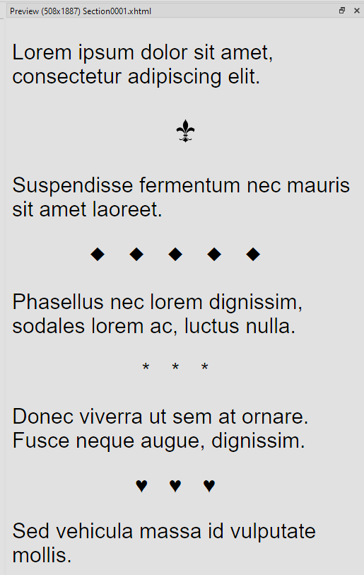

I usually use a dinkus (* * *) for a section break, what would the semantically correct way to tag this? The little accessibility reading I've done suggests mapping this to <hr>, which would explain why many ebooks I've read have both a horizontal line, and a fleuron -- which I find a little annoying, strictly from a presentation point
<hr/> is the recommended method. I can only blame the programmers for showing both a line and the dinkus (didn't know it was called that!! ). Either the device/app programmers for not making their device function properly, or the book coder for not putting the proper css on their stylesheet.
Here is the method I use and I haven't seen it display both on my readers.
Adjust the image, margin, height, and letter spacing as desired
CSS:
hr {border:none; margin:1em auto; text-align:center; letter-spacing:1em}
/* using an image fleuron*/
hr.ChDiv1 {
  height:2em;
  background: transparent url("../Images/img_ChDiv.svg") no-repeat center;
  background-size: auto 100%;
  overflow: hidden;
  page-break-inside: avoid;
/* using symbols*/
hr.ChDiv2:after {content:'◆◆◆◆◆'}
hr.ChDiv3:after {content:'***'}
hr.ChDiv4:after {content:'♥♥♥'}
HTML:
  <p>Lorem ipsum dolor sit amet, consectetur adipiscing elit.</p>
  <hr class="ChDiv1"/>
  <p>Suspendisse fermentum nec mauris sit amet laoreet.</p>
  <hr class="ChDiv2"/>
  <p>Phasellus nec lorem dignissim, sodales lorem ac, luctus nulla.</p>
  <hr class="ChDiv3"/>
  <p>Donec viverra ut sem at ornare. Fusce neque augue, dignissim.</p>
  <hr class="ChDiv4"/>
  <p>Sed vehicula massa id vulputate mollis.</p>
Name:	Screenshot 2024-01-31 100255.png
Edit:
The slight offset from center you see with the fleuron is because, in this example, I left the letter-spacing for all <hr>s. If you use a fleuron image, just remove the letter-spacing and the image will be perfectly centered.

As to the section break, you need to use <hr.transition> for accessibility. The following code works well.
hr.transition {
  margin-top: 0.9em;
  margin-right: 40%;
  margin-bottom: 0.9em;
  margin-left: 40%;
  border-top: 2px solid;
And you do not need to go back to InDesign to fix any of this. You can do it in calibre and/or Sigil much easier.
