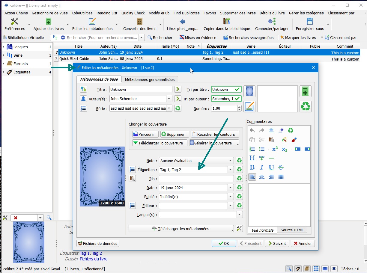

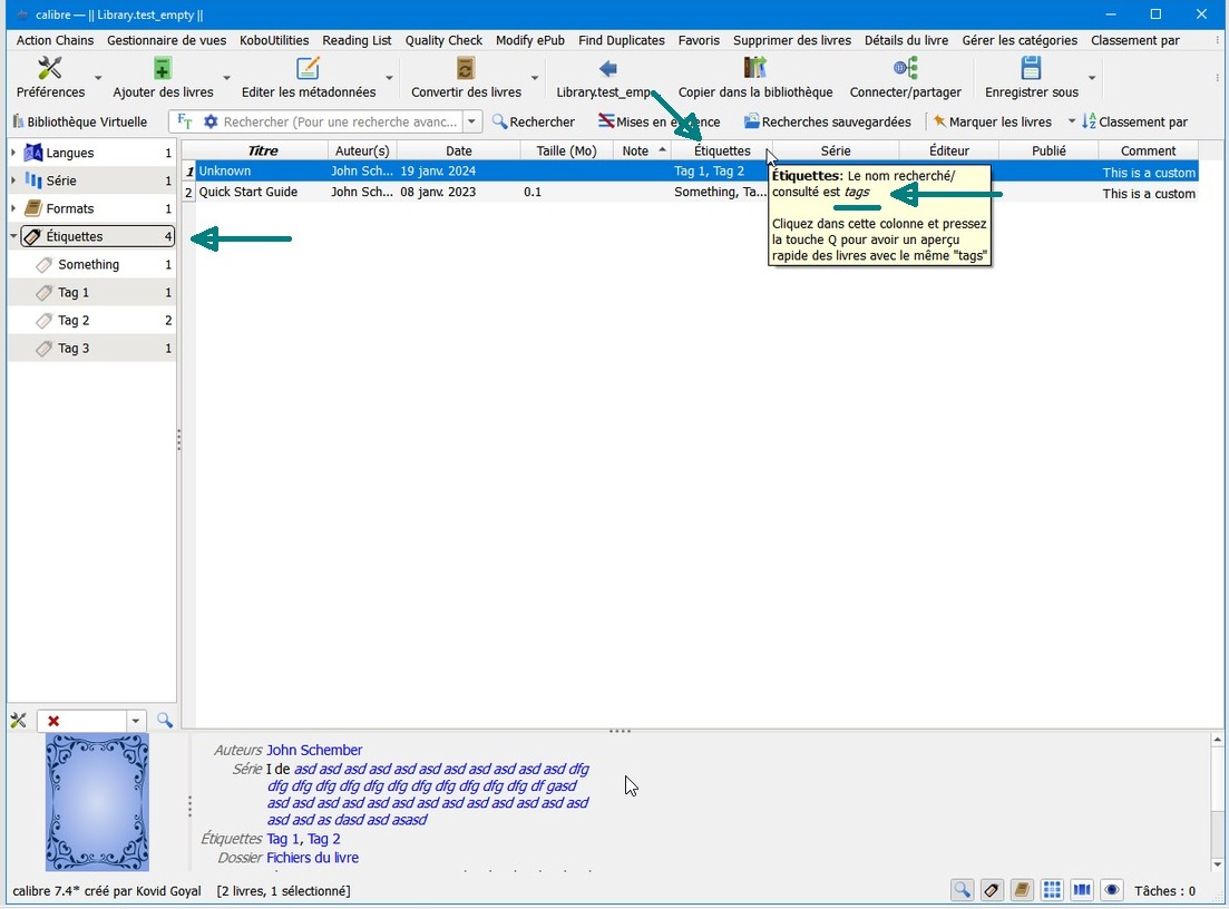

I strongly recommend that you watch the Introduction to calibre video.
Why did you put "tags" into the Kobo collections setup dialog if you don't know what they are?
The two images below show how tags are displayed and edited in calibre. I switched calibre to French to (I hope) make it easier to understand.
This is the calibre main interface, showing the tags column and the tag browser.
This is the calibre edit metadata dialog showing where you can modify the tags.
