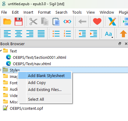

2. I do not find "Add Blank Stylesheet" on my Sigil, neither in the "Tools" nor "Insert" menu items. Is it just a new clip?
Right click on Styles in the Book Browser window, click on Add Blank Stylesheet. See attached image.

Old 01-27-2024, 07:24 AM   #12
roger64
Posts: 2,625
Karma: 3120635
Device: Kindle PW3 (wifi)
Thanks David, I did not think to look here.
