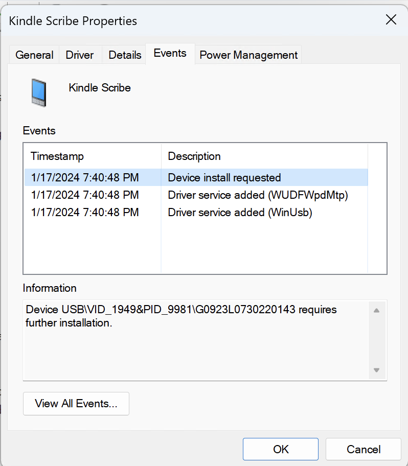

Old 01-17-2024, 11:50 PM   #732
tomsem
Posts: 7,263
Karma: 28183005
Join Date: Apr 2009
Device: iPad Mini, Kindle Colorsoft, Kindle Scribe Colorsoft
I connected Scribe to a very new Windows 11 Pro system, no issues.
Same version information in Device Manager. The Events tab shows service being added (first time I've connected it to this computer).
Name:	Screenshot 2024-01-17 at 7.48.23 PM.png
Old 01-18-2024, 04:05 PM   #733
DuskyRose
DuskyRose ought to be getting tired of karma fortunes by now.DuskyRose ought to be getting tired of karma fortunes by now.DuskyRose ought to be getting tired of karma fortunes by now.DuskyRose ought to be getting tired of karma fortunes by now.DuskyRose ought to be getting tired of karma fortunes by now.DuskyRose ought to be getting tired of karma fortunes by now.DuskyRose ought to be getting tired of karma fortunes by now.DuskyRose ought to be getting tired of karma fortunes by now.DuskyRose ought to be getting tired of karma fortunes by now.DuskyRose ought to be getting tired of karma fortunes by now.DuskyRose ought to be getting tired of karma fortunes by now.
DuskyRose's Avatar
Posts: 767
Karma: 9209502
Join Date: Apr 2007
Location: Virginia
Device: Boox Note Air3, Palma, K-Scribe, Eclipsa 2e, & Libra 2, Ipads
What size scribe do you have?
I have the 64GB and load them up heavily. I'm aware that there may be too much on it for the programs to handle. I usually find out the hard way, then factory reboot and reinstall.
Just strange, through, for the connection problems to happen on the day it updated.
