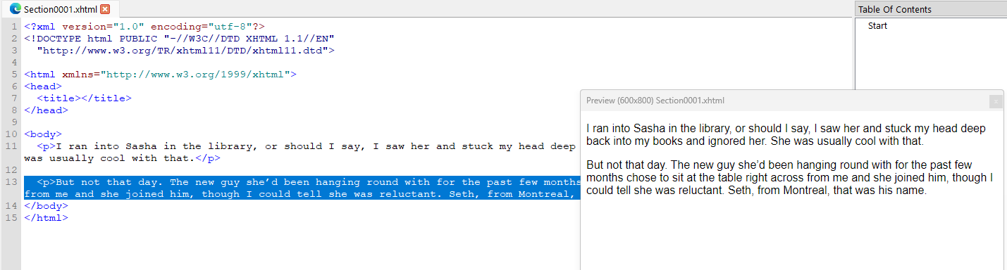

It is the intended behaviour. It is not supposed to modify the appearance of the code but of how the code is rendered for the user to view. Pop up the Preview screen and see the effect. Please note all the tools in the Format group affect how the text displays and should not affect how viewing the code.
ID:	205706   Click image for larger version
