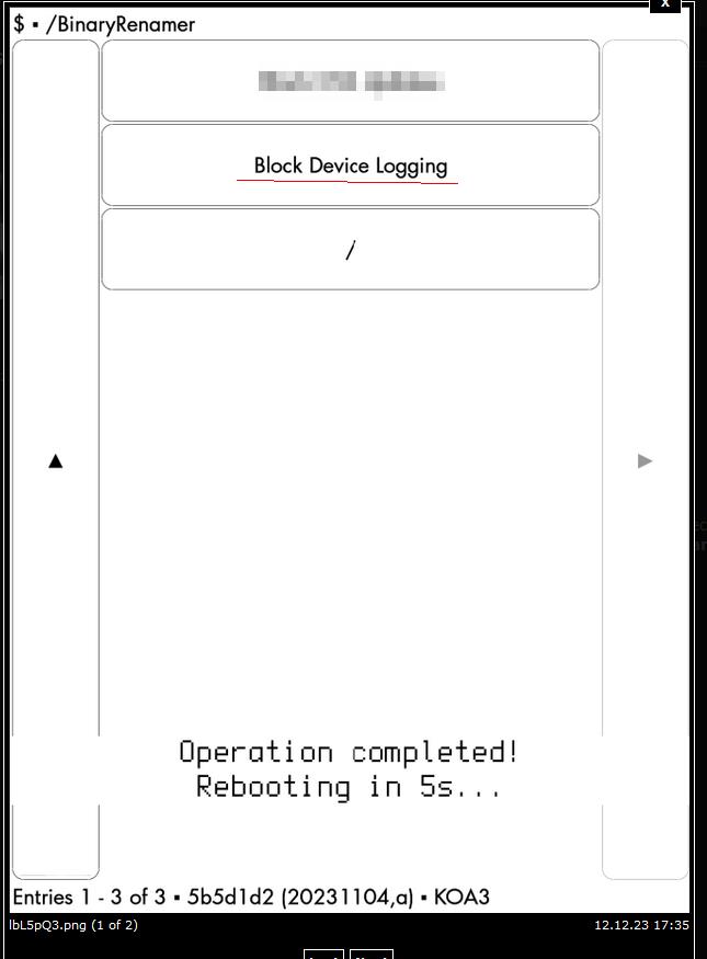

Hi, I had to reset my kindle KOA 5.12.4. I had before renameotabin. I tried this one and it only shows the logging menu part.
I dont know if its the version of kindle.
ninki is offline   Reply With Quote
Old 05-27-2024, 04:28 AM   #29
juliazero
Trans girl (she/her)
juliazero is slicker than a case of WD-40juliazero is slicker than a case of WD-40juliazero is slicker than a case of WD-40juliazero is slicker than a case of WD-40juliazero is slicker than a case of WD-40juliazero is slicker than a case of WD-40juliazero is slicker than a case of WD-40juliazero is slicker than a case of WD-40juliazero is slicker than a case of WD-40juliazero is slicker than a case of WD-40juliazero is slicker than a case of WD-40
juliazero's Avatar
Posts: 81
Karma: 73450
Join Date: Nov 2023
Device: KOA3 5.18.2 JB
You mean it shows only this?
juliazero is offline   Reply With Quote
Old 05-30-2024, 03:08 PM   #30
ninki
ninki began at the beginning.
Posts: 71
Join Date: Aug 2008
Device: Hanlin 6.1, Kindle 3, Kindle Touch, KPW3, KOA3
Attachment 208527
Yes, Just like that
