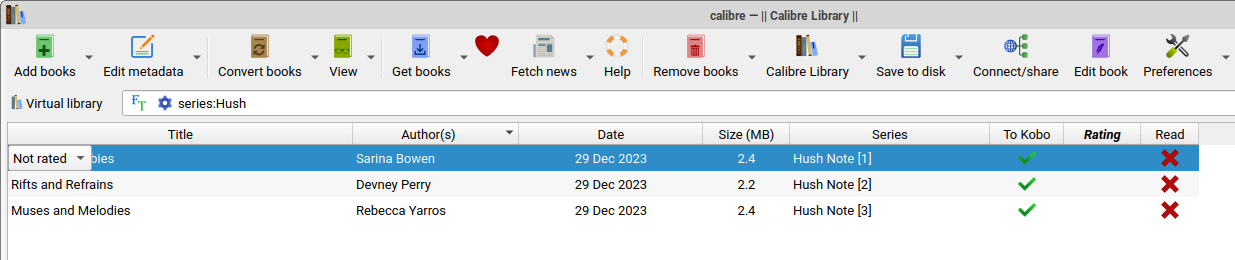

I have a minor display error in Calibre 7.3 .... When I click on the "Rating" field, the combo box shows at the far left side of the line, rather than in it's correct column location - see the attached image.
Other notes:
  • Other fields do not do this
  • It doesn't seem to matter which columns are included in the view
  • This is new behavior in 7.3
  • If I resize the main window far enough to get a scroll bar across the bottom of the columns, then the "Rating" combo box appears in the right place.
  • I'm running Grant Drake's "View Manager" plugin, and normally set a specific view on startup, but turning off this behavior doesn't fix the display

After many tests I have found the fault and how to temporarily solve it.
It affects View Manager and the width of the affected column or columns.
Temporary solution: Increase the width of the affected column (or columns) and execute the desired view with View Manager.
This must be done every time you open Calibre.

GREAT fix, thanks!
I have View Manager set to load a view on startup - with the slightly wider column the display error is also gone at startup. I DID click "Save View Columns" after changing the width.
