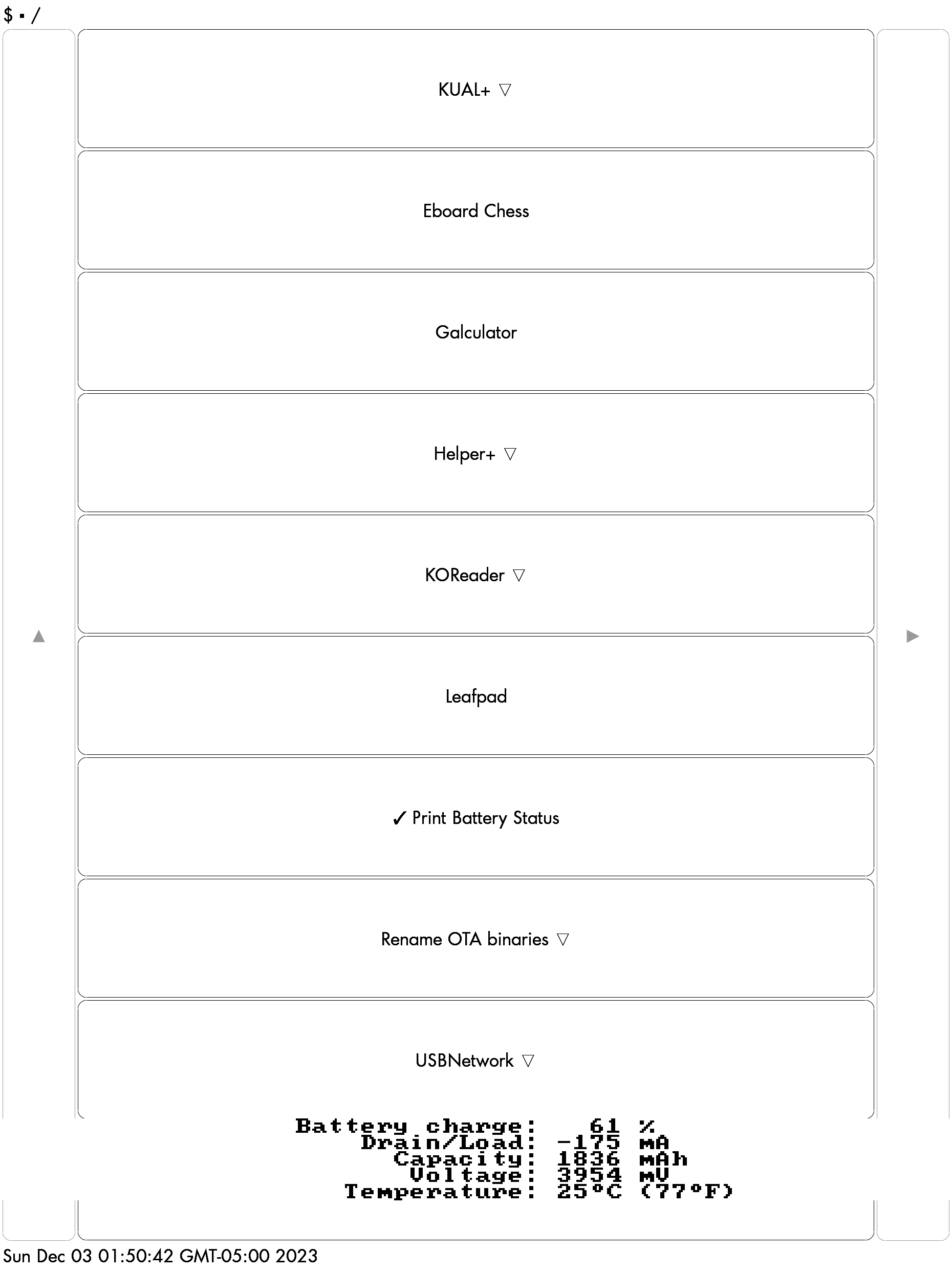

Originally Posted by Daviteusz View Post
I'm thinking about how to adapt this to oasis3 but without changing the scribe version and how to center the text to the colons...
Try out this version, works on Kindle Scribe.
1) Aligned all colons
2) Added preventive paddings with leading spaces
3) Voltage has now separate line
4) The percentage sign is printed OK with eips, the old comment must be referring to very old FW...

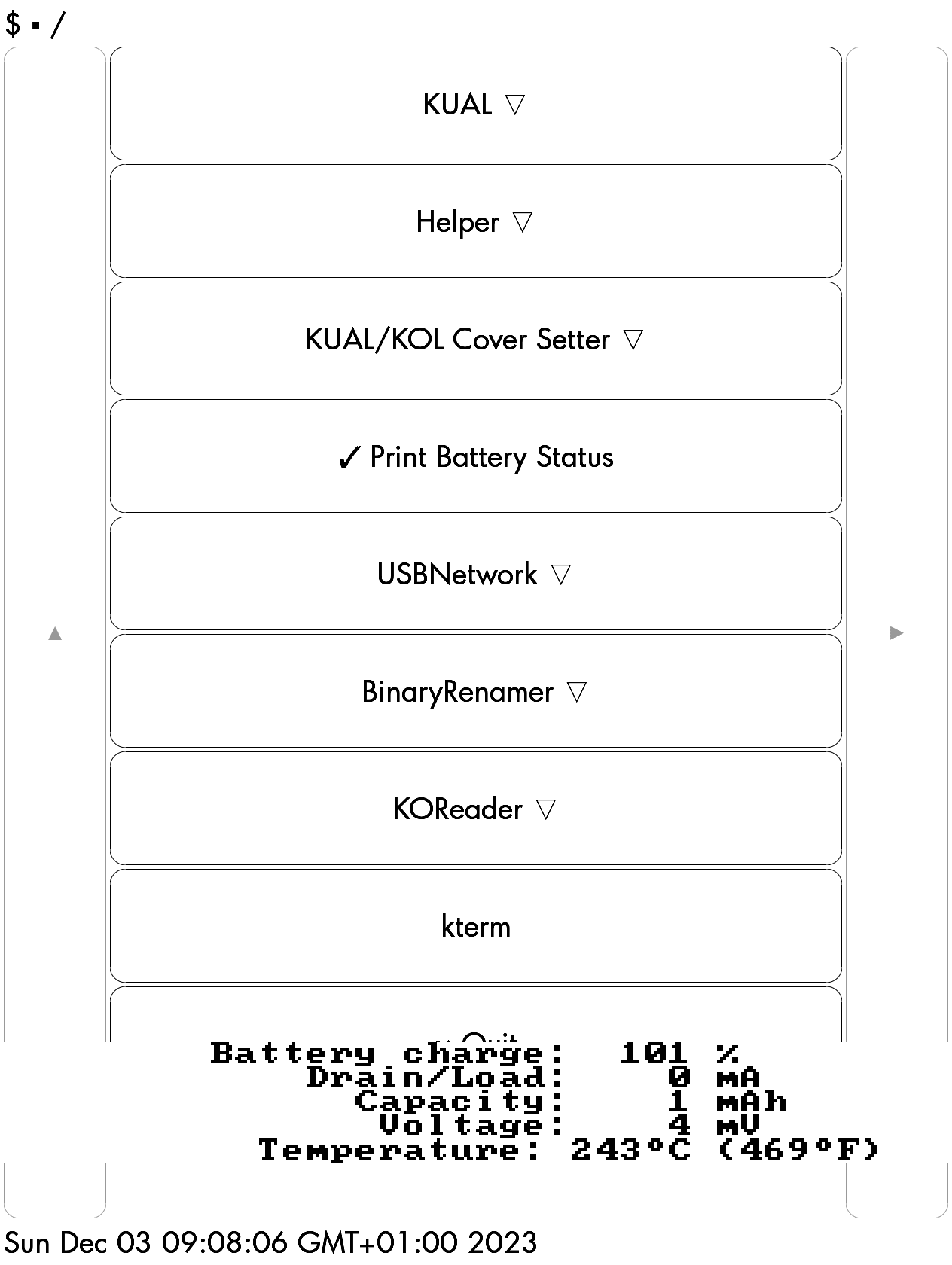

I'm getting different data from commands:
[root@kindle bin]# gasgauge-info -c
100%
[root@kindle bin]# gasgauge-info -l
-49 mA
[root@kindle bin]# gasgauge-info -m
1074 mAh
[root@kindle bin]# gasgauge-info -v
4281 mV
[root@kindle bin]# gasgauge-info -k
242 #24.2°C?
From KUAL:
