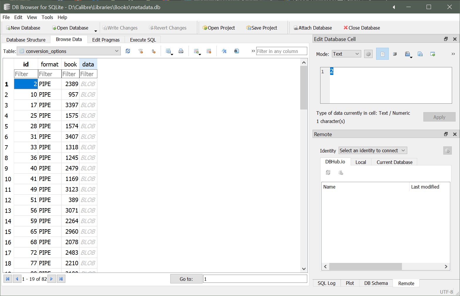

Originally Posted by Cbp001 View Post
Thanks, this would’ve been the perfect solution but for some reason I don’t get any conversion parameters when I try to reconvert an older epub. Maybe because I switched my collection from windows to Apple along the way or some other reason. Any other way I could find these old settings?
FWIW: the way I've discovered which books, if any, have book specific conversion settings is to examine the conversion_options table in the library database (metadata.db) using the DB Browser tool.
