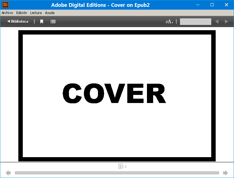

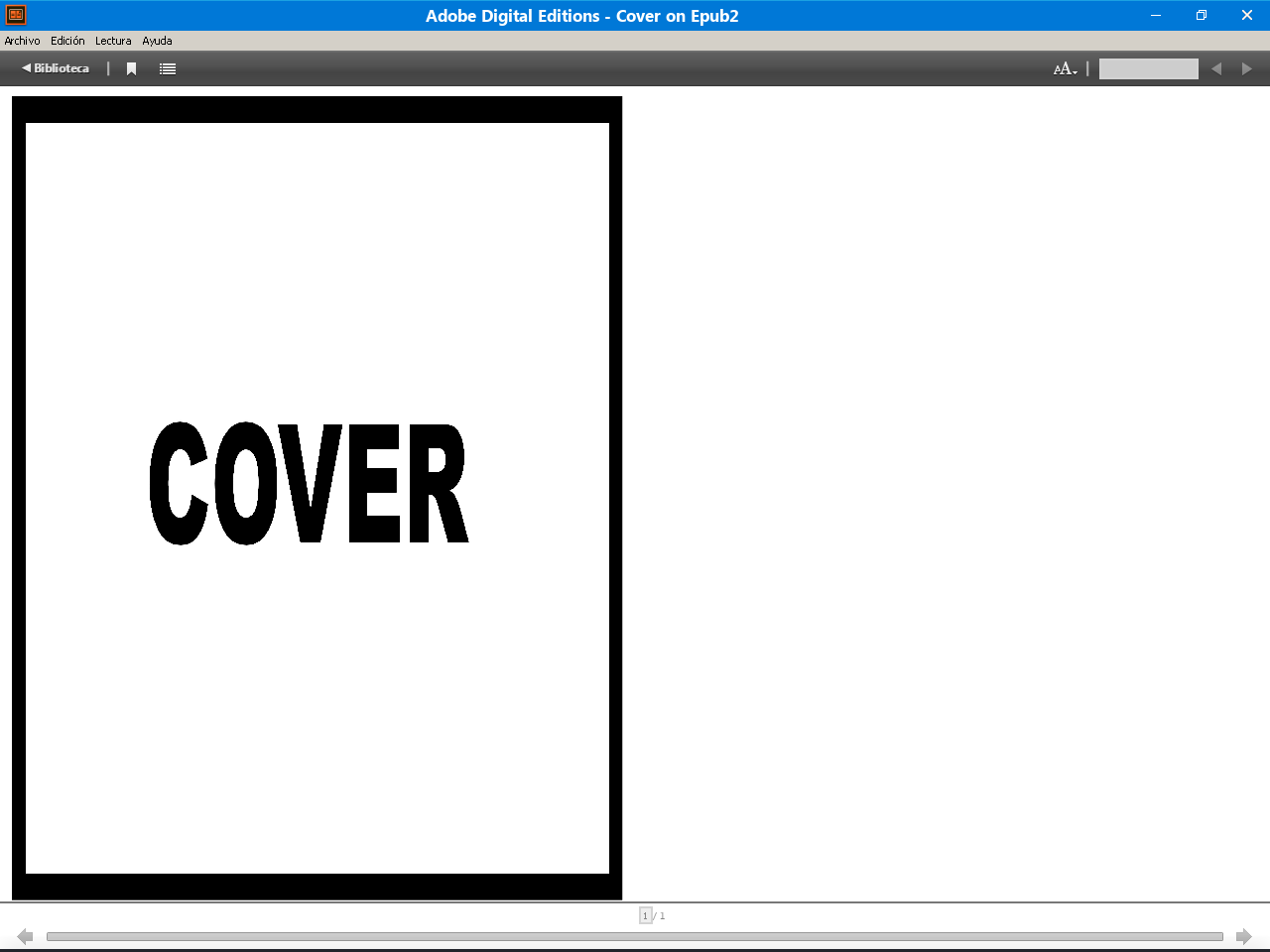

Old 12-14-2023, 07:06 PM   #13
RbnJrg
Posts: 1,933
Karma: 9600001
Join Date: Mar 2013
Device: Kindle 4 NT
Forget SVG. Not every ePub reading software will work with SVG. My way has the best chance of working.
That is not true; sorry to be harsh, but your code doesn't work. This is how it looks under:

And your code use as anchor the "height" property (height: 100%); so, what happens when the "width" of an image is bigger than its "height"? Because the properties "max-width" and "max-height" are not supported by ADE Legacy (ADE 2.x), it happens the following:
Name:	Landscape cover.png
ID:	205202 Click image for larger version
Name:	Landscape cover 2.png
The cover can't maintain its proportion. Conclusion: your code doesn't work. I'm wondering if you seriously tested it under ADE 2.x.

Attachment 205202 Attachment 205203
