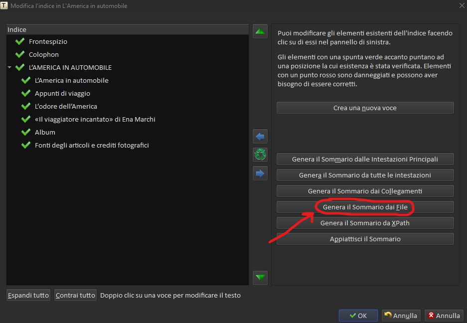

If not the content of specified tags, I'm curious what the calibre feature mentioned uses for the content of a toc created "from the files (one entry for any html file)"?
Hi,
I have attached an image of the TOC Calibre creator.
AstroCalibre is offline   Reply With Quote

Originally Posted by Karellen View Post
Where?
Sorry, I'll try to attach it here again
Name:	Immagine 2023-12-09 163554.jpg

I didn't need an image anyway. I merely want to know what text is being used to create a toc entry for html files in calibre. It can't come from the filenames themselves, so it has to come from somewhere in the html itself (the contents of tags) or manual entry. Either way (sigil or calibre), something needs to be prepared ahead of time for the create toc features to be able to function.
Hi, DiapDealer, this is the tooltip of the command:
Generate a summary from the individual files in the book. Each entry in the table of contents will point to the beginning of the file, and the text of the entry will be the first line of text in the file
