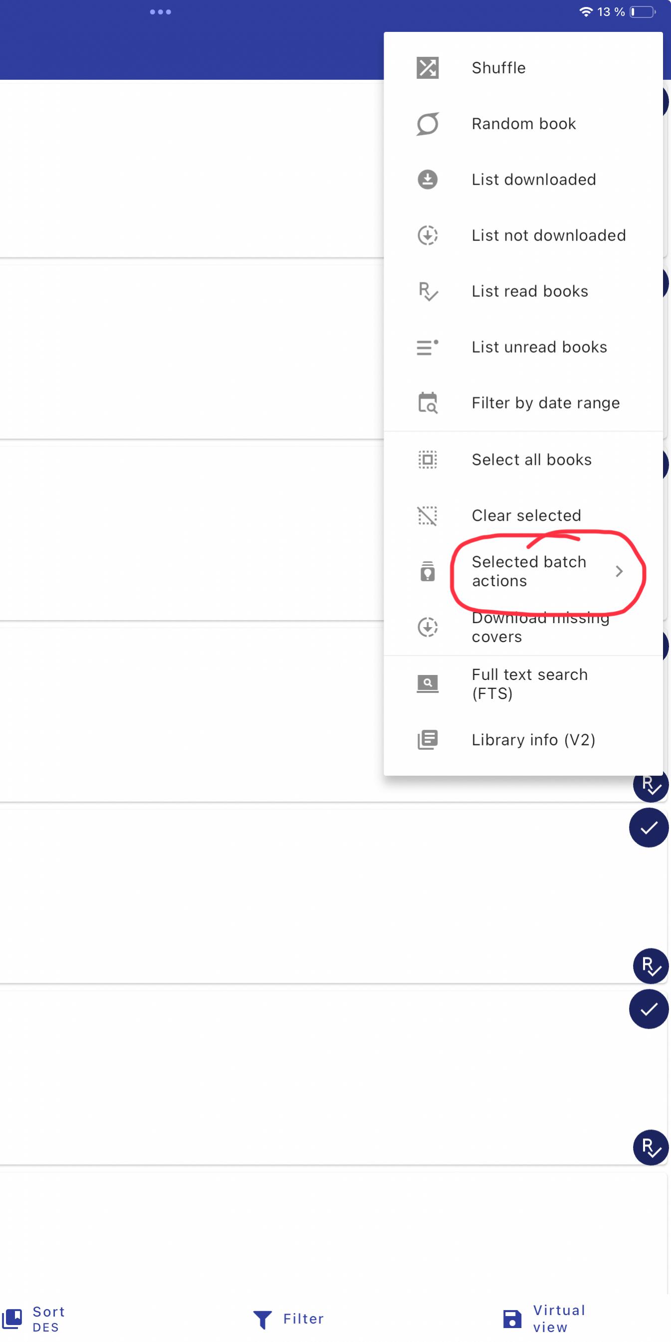

For metadata and having all the books on your device follow my instructions.
Copy the entire Calibre folder which contains your library to your phone in the directory advised by CS.
This folder has your books and your metadata (metadata.db file).
I can’t tell you more, it’s really that simple
Edit: for batch actions
Touch and hold the books until a check mark shows up.
Then

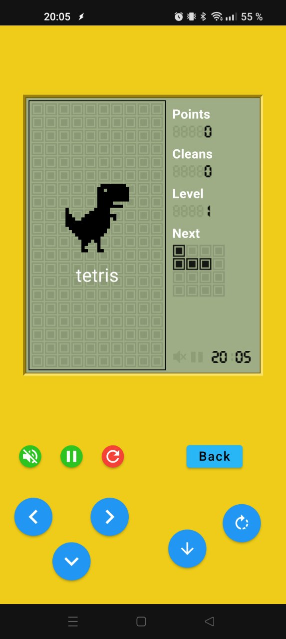

Originally Posted by Tigressdance View Post
- was there really a tetris game hidden in the logo of the app? I didn't play it, but it made me laugh and go, 'what?'
Yes tetris game

Yes tetris game
lol - I have never clicked on the logo until now.
