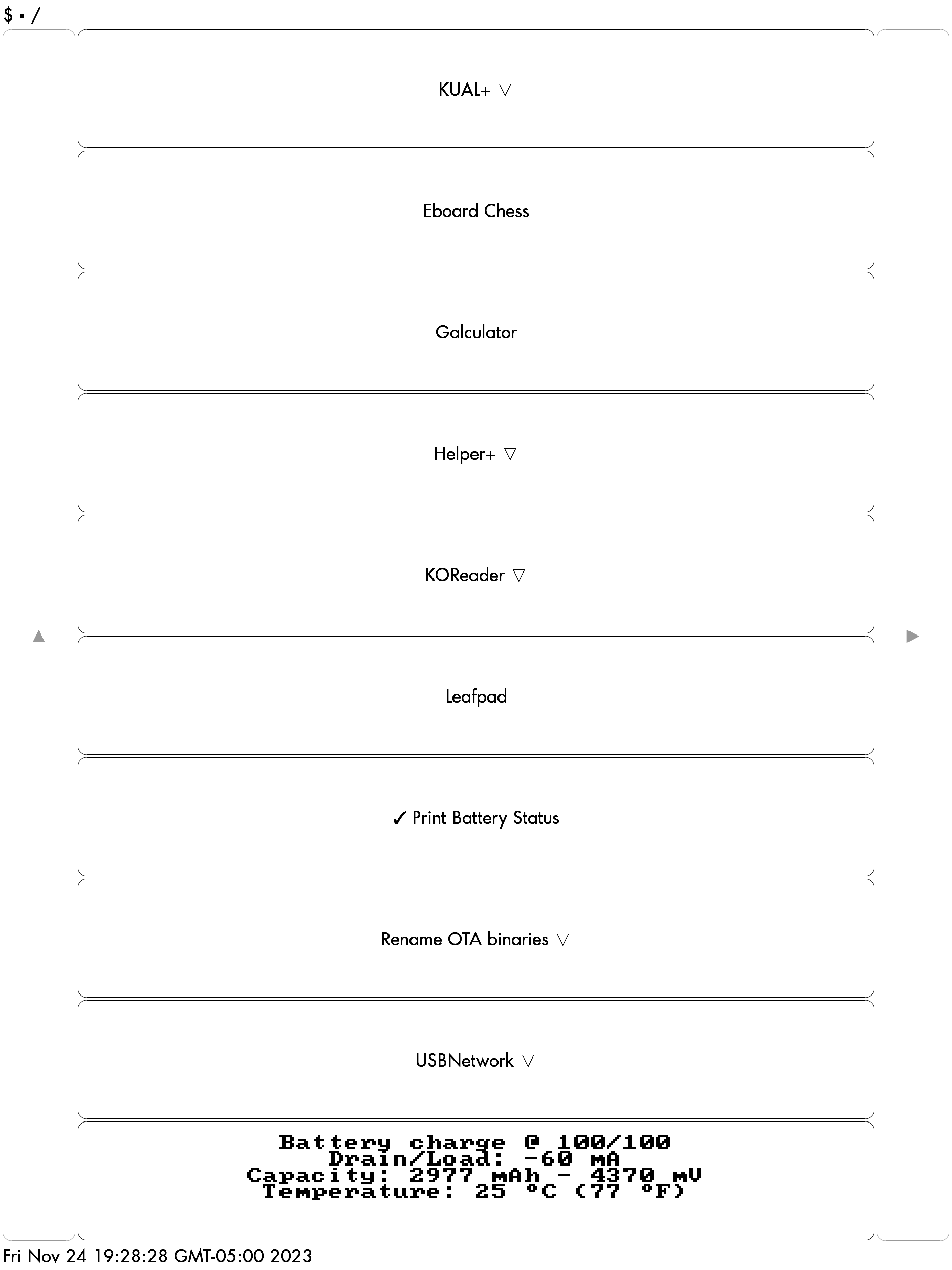

Alright, here is the fixed version. Tested on 5.16.2.
I also put it in the root of KUAL menu.

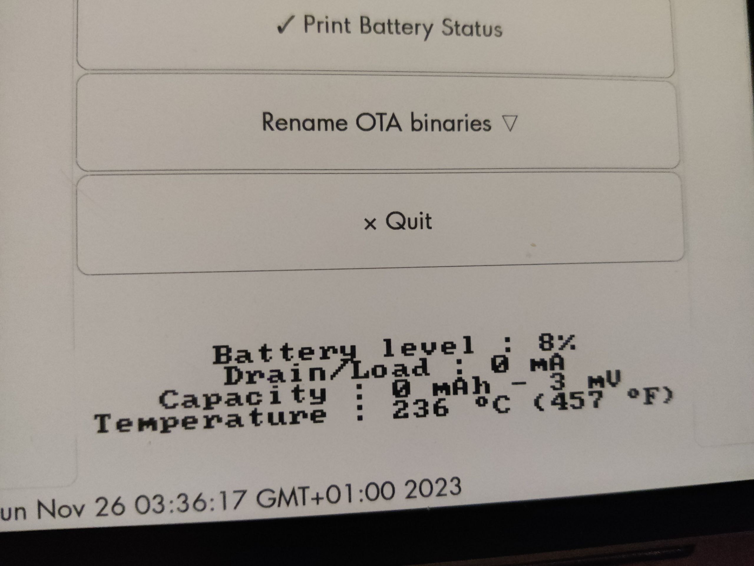

I'm thinking about how to adapt this to oasis3 but without changing the scribe version and how to center the text to the colons...
