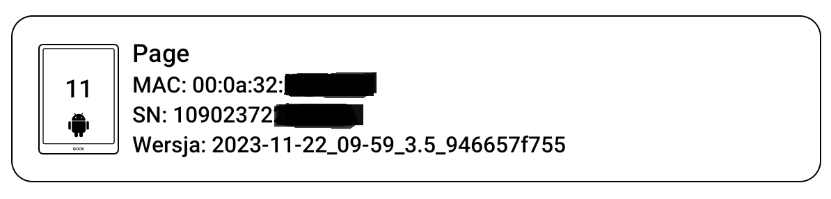

For the record: my BOOX Page was updated from v3.4 to 3.5 about a week ago, in the last days of November.
