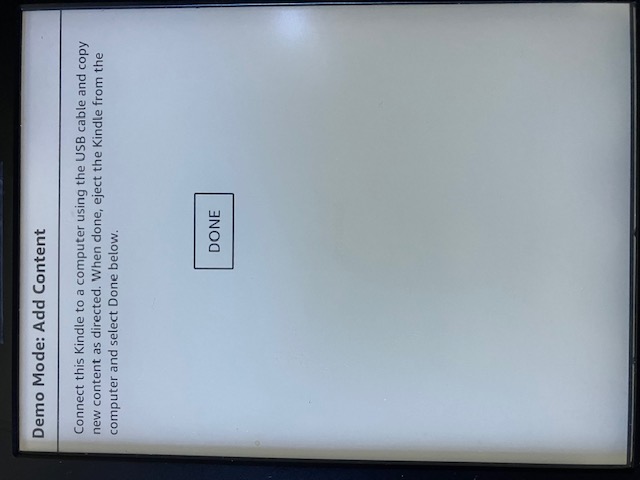

Repost of screenshots; large image size
Repost of "medium" size image vs previous post of "small"

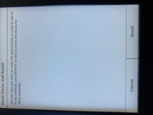

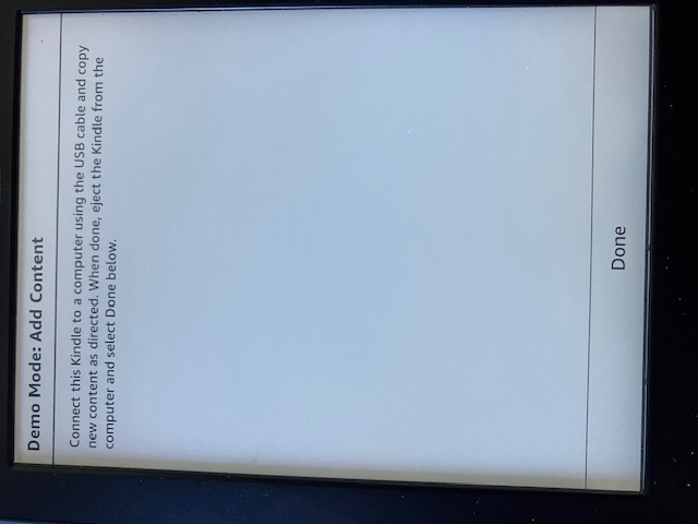

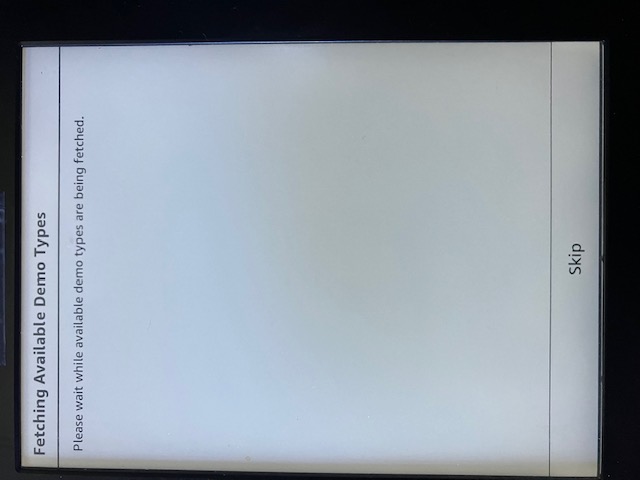

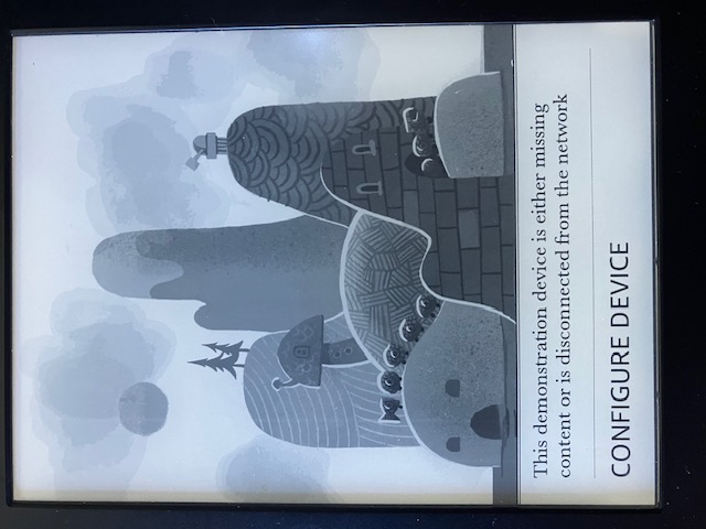

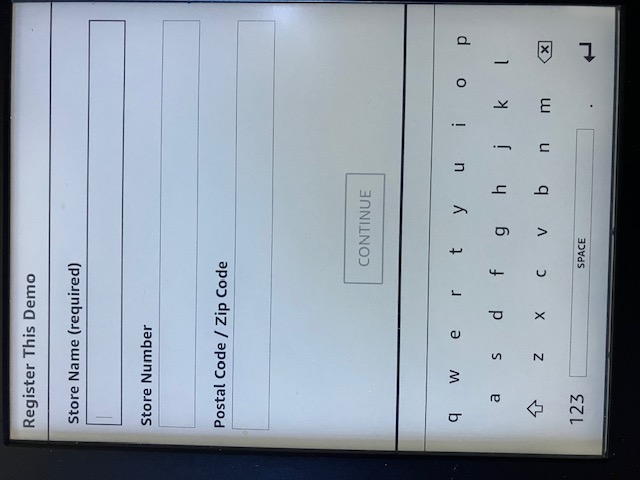

1. Type ;enter_demo in the Kindle search bar
2. Reboot the device
3. Once in demo mode, skip setting up wifi and enter random values for store registration
4. Skip searching for a demo payload
5. Select the "standard" demo type
6. Press "Done" at the prompt to sideload content.
7. Once the demo is setup, do the "secret gesture" (double finger tap on bottom right of screen then swipe left)
8. Enter the demo configuration menu by typing ;demo into the search bar
9. Select the "Sideload Content" option
10. Copy the contents of the LanguageBreak folder to the Kindle - merging and replacing all files
11. Unplug your kindle and go back to the demo menu (viz. step 8)
12. Select the "Resell Device" option press Yes/Resell
13. Now wait for the press power button to start
14. The second it appears plug your kindle back into your computer and copy the contents of the LanguageBreak folder into it once again, overwrite files then safely eject
15. Hold the power button as instructed on screen
16. A language selection menu should appear in a few seconds
17. Choose Chinese (The one above the odd Pseudot language, and/or below Japanese)
18. Your kindle should reboot and you should see some log message on the screen

It's OK, you were trying to be considerate. There is a limit on individual image size, but it is plenty for a good sized image.
Just so I undertand, sometimes an screen comes up in English and the correct selection is somewhat obvious and sometimes that same screen might come up in Chinese? When it comes up in Chinese, is the layout and location of the selections the same as on the corresponding English screen?
Reposted as "medium". The layout appears to be the same, meaning I could click "Resell" based on relative location on screen. Was good enough to dig myself out of hole, can't promise everything is one-for-one, but was a good crutch.
