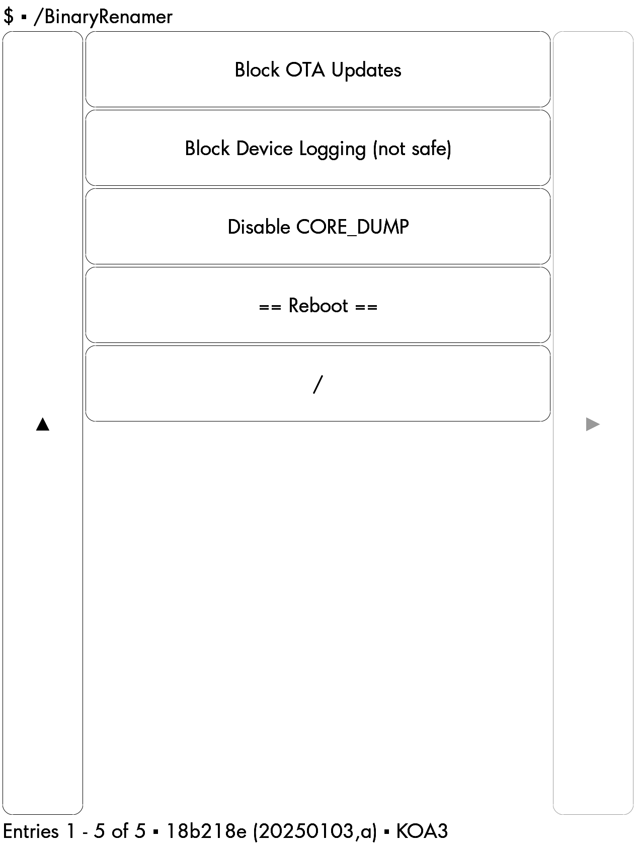

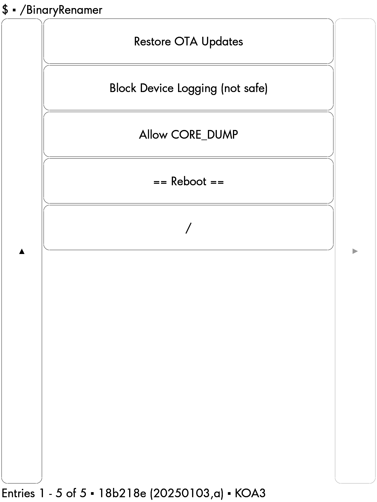

Screenshots:
ID:	215499Click image for larger version

Usage:
Block OTA Updates:
This button works similar as Rename button in renameotabin extension by @hius07
The following files will be renamed:
• /usr/bin/otaupd --> /usr/bin/otaupd~
• /usr/bin/otav3 --> /usr/bin/otav3~
As you might have noticed, the suffix ~ has been added to the binary files.

Restore OTA Updates:
The above changes will be revoked, UYK will operate again.

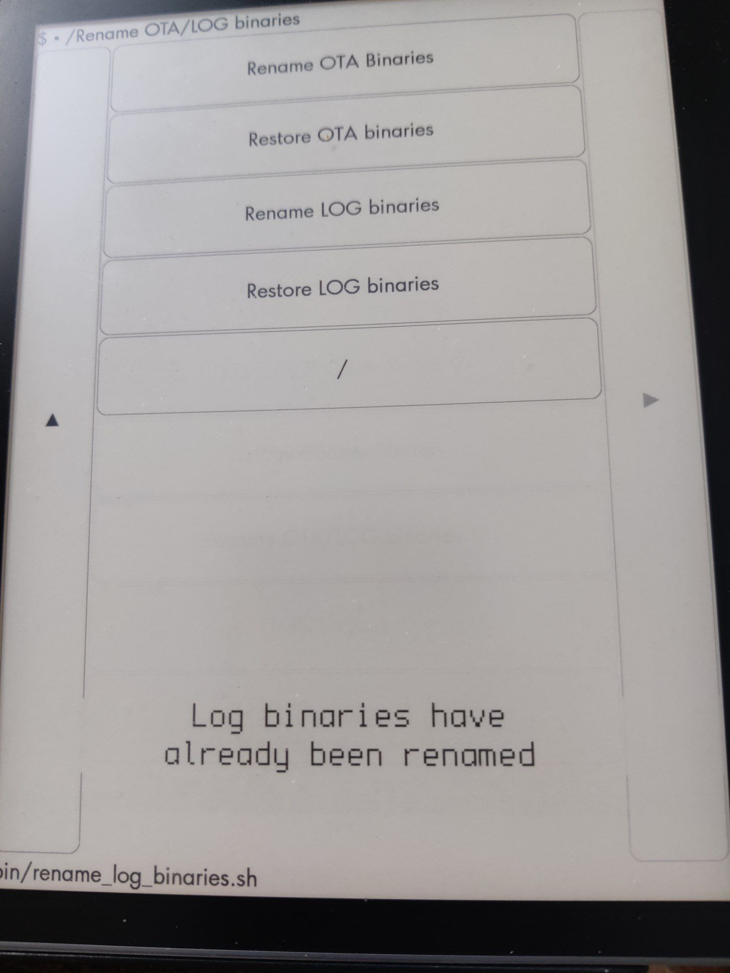

Originally Posted by mergen3107 View Post
For your todo #1, have a look at NiLuJe’s fbink.
Thanks! Looks promising:
juliazero is offline   Reply With Quote
