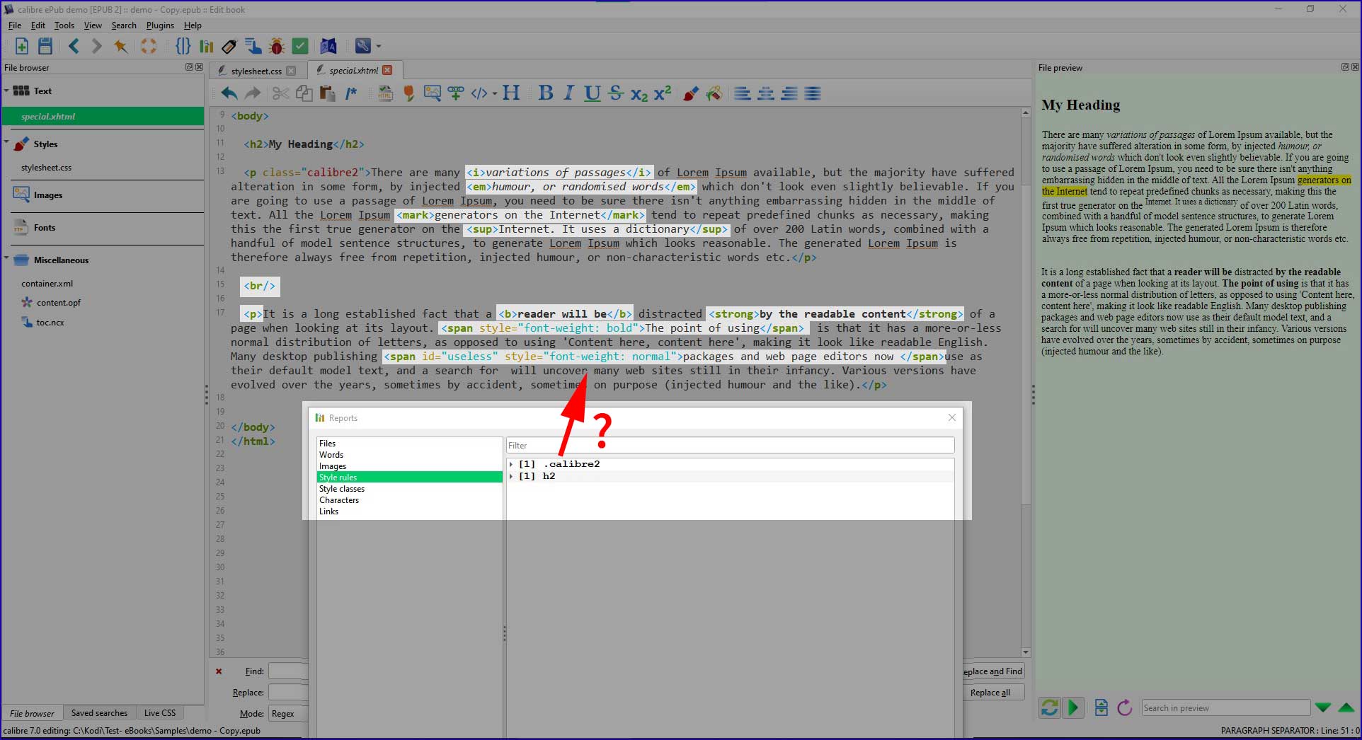

Hello @kovidgoyal
Often I find spurious code scattered throughout the ebook and these elements can be overlooked during clean up. Only by stumbling across them by accident, or reading the book in editor view, are you able to find them. For example, finding a single <tt></tt> element in a 150,000 word book will be quite difficult. (assume that you don't know it is there)
The reports component of the Editor is a very useful feature, but I find it a bit lacking and does not provide a complete overview of the coding, so the spurious codes can be overlooked during cleanup. For this reason I would like to request additional reports to give a complete view of the coding in the ebook.
In particular, I am referring to the two reports "Style rules" and "Style classes"
"Style Rules" simply lists the complete css file and applies a usage counter.
I find this misleading because the report is locked to the css file, and if a tag is not in the css file, it is not displayed, yet there could be many instances of its use in the ebook.
This should be renamed to CSS rules to avoid the misinterpretation that it will show all elements.
See image 1

What you can see in both images, is that the ebook can be infested with code, yet neither report shows any of it.
What is additionally needed is one report to show all tags in use (image 3) and another report to list inline styling - maybe a report named "Inline styles" or maybe a report showing all attributes in use. This would make it much easier to track down coding that needs attention.

style rules is not linked to a particular css file its for all css files and even inline <style> tags. I'm not particularly keen on reports for tags used or style attributes, there's too little use fo the former and too much variation in the latter.
