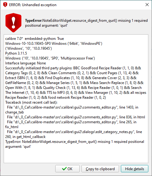

Old 11-19-2023, 08:30 PM   #138
crnirg
crnirg began at the beginning.
Posts: 71
Location: Niš, Srbija
Device: TCL Nxtpaper 11, Kindle PW 2024
When add picture with the C/P image I get this error:

Posts: 2,061
Karma: 7956099
Join Date: Sep 2020
Attachment 204818
I get that too, running from source. But it's awesome that Calibre can already retrieve the images after the latest commit!
https://github.com/kovidgoyal/calibr...425d72f0105f29
