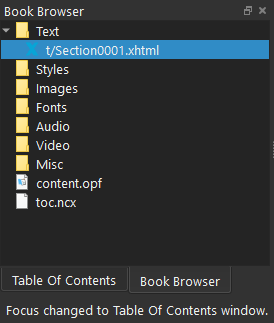

I have noticed that if sub-windows are merged (e.g. TOC + Book Browser or TOC + Clips) then the focus changes, but the called window is not switched to the foreground.
You can see this clearly in the attached screenshot.
The Book Browser is still visible, despite the change of focus to TOC.

Tabbified qdockwidgets have always behaved with a mind of their own.

Yes I am seeing the same thing on macOS. Not sure how to detect if QDockWidget is tabbified and not the front tab.
Will try to see if there is any solution.

I did a trial and raise() seems sufficient.
It doesn't need to be added to the Code View, as no other widgets can be added to this window.

Well it seems with multiple main windows on macOS, the visibleRegion().isEmpty() test failed sometimes and so no raise was done but needed.
I think the safest way to handle this is to use raise() called immediately after FocusOn call and before the specific internal subwidget is given focus. This should not hurt anything and works on macOS as well.
I also added a nullptr check for each to make sure the QDockWidget in question has not been deleted yet for safety in case someone deletes a main Window and shortcut keys or key events are waiting to be flushed out. This is more of a concern on macOS with its multiple main windows but is safer for everyone.
I have pushed this master. If you get a chance please make sure I have not hurt anything on Windows. It should all be okay but just to make sure.
I think with this change, we should consider this new feature as complete.
