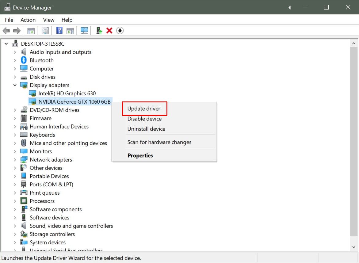

That's the QT environment variable.
Drivers are updated via the Device Manager, type "device man" into the start menu and Windows should offer it, then:
Name:	Screenshot 2023-11-19 145318.jpg

Oh right. I did try that before but it says the driver is up to date.
Name:	2023-11-19 00_10_23-Update Drivers - Intel(R) UHD Graphics 620.png
