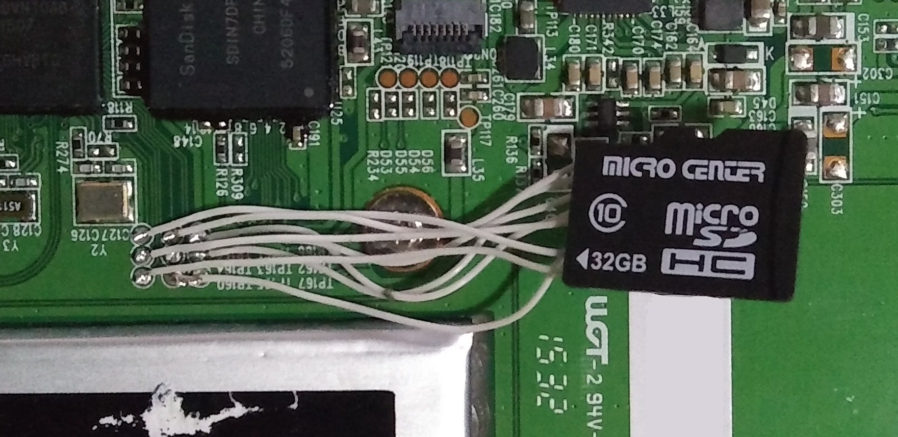

first of all, hi there first post here
so i have this storytel reader, that i cant use anymore because storytel bricked it with an update, so i started with opening it and noticed on the mother board it says boox_c67_rk3026 v1.76.
Then i started googling and found this site and a russian site with information about boox and software to flash the rockchip, so i tested around and found that the darwin4 full firmware was able to boot the device, but the issua was that the touch screen and the buttons didnt work. so that is probebly the wrong firmware.
so my question here is, does anybody know or recognice the motherbord ? what boox device and version is this and what firmware do i need to get it working propperly again

BTW, what are all those wires for? Did you mod your device physically to reflash it?
I'm guessing that they were used to connect an SD card.
I'm not sure if the length of the wires were a problem.
I prefer shorter wires.

hello everyone sorry for being away
yes i did test solder a sd card to it, but i soldered a sd card reader instead now
