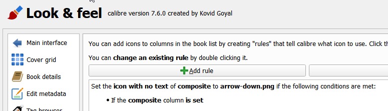

Old 03-03-2024, 06:08 PM   #131
chaley
Posts: 12,529
Karma: 8125420
Location: Notts, England
If the composite column is represented in the Book list by an icon without text will the template result (i.e. the image) show as a tooltip… assuming one hasn't turned book list tooltips off?
The tooltip will display the contents of the column that has the icon. Whether that is a note depends on the composite's template.
Example: a composite with the template
program: get_note('authors', $authors, '')
and this icon rule
produces this
NB: get_note() is rather slow, which is why I said you probably shouldn't show the column in the booklist. Showing it icon-only is still showing it, as the template will be evaluated.
