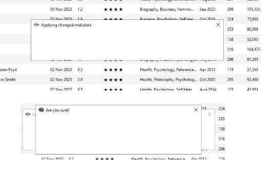

I'm having an issue with this event where the next step in the action chain fires before the "applying metadata" dialog box / process finishes. If any of my subsequent actions involve metadata, it results in a Calibre dialog box that the metadata has changed. My current workaround is to add a lengthy pause after updating the metadata, but the amount of time the pause varies on the metadata and number of books selected.
To confirm this, I placed a dialog box in the step immediately after updating metadata, and you can see it appears on top of the "applying metadata" box.
I have a copy of the calibre temp folder that was generated during the action chain, and can provide that privately. I also have a video screen recording.
In the action settings, make sure to tick the box "Wait for the metadata download jobs to finish"
I have that checked.

I just tested and was not able to replicate you problem with the option checked. I've never actually used this action myself. Maybe some of the users who use it can chime in.
