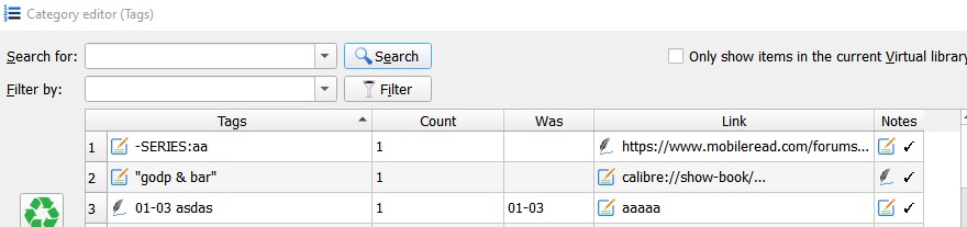

Doh, I assumed a ✔ in Manage Categories was a signal that a note for the item existed, for some explicable reason it didn't twig that I could tab to the cell and press F2 to enter/edit the item's note (just as I can for a link)
For info, a first implementation used buttons that was more explicite button, but drop du to perfomance issue.
To Kovid, that was possible to implemente a unique button as a cell (button of we modified properties dynamically according to the note it represents), or that is still to much bad regardless the perfomance?
There were two performance problems:
  • creating many thousand pushbuttons in Qt is slow. Each cellWidget had 3. A user-provided test library had 36,000 author rows, or 100,000 buttons.
  • cellWidgets are themselves very slow. I had read about that problem when doing the initial implementation but didn't test with a library big enough to run into the problem. Doing the beta fixed that oversight.
The performance problems can in theory be eliminated by using a styledItemDelegate instead of cellWidgets and drawing the buttons instead of creating button widgets. However, that seems to require writing the delegate in C++, which requires rebuilding calibre's binary for every test. This wasn't something I wanted to try.
Kovid's "checkbox" solution is performant, purely in python, and easy to understand. With a context menu offering create/edit, delete, import, and export (which exists) it works well enough.

yeah i dont think using a cell widget is workable with large libraries. The "right" way to fix this if not use QTableItems and instead use a proper model with caching. And then use a styled delegate that draws its buttons based on the data in the model for the current cell. And then it will have to handle mouse events and so on, its a lot of work. I think the checkmark is a reasonable compromise. One can add a tooltip to it saying press f2 to edit or whatever.
@charles: I think a styled delegate would be doable in python but given that it has to handle events and state and so on it will be a lot of work

Another way to "fix" this is to use an "is editable" icon, perhaps edit_input.png. It could go on non-edited cells, just as the "Edited" (quill) icon goes on edited cells. Something like this:

Suggestions :
  • replace the ✔ with a pencil to match what's in Book Details;
The check mark is a character, which permits showing both the "edited" icon and the check mark. Only one icon can be applied to a cell, so if we use the pencil icon then we can't use the edited icon. The edited icon can't replace the checkmark because a deleted note is edited with no check. I suppose that someone could invent a set of icons to indicate the 4 states (empty not edited, empty edited, exists not edited, exists edited), but that is neither something I am good at nor want to do. Perhaps someone else is willing to take it on.
  • put tooltips in the Category editor headers - as per the Book list.
Headers in the Qt table widget don't support tooltips. As Kovid said a bit back, getting tooltips really requires switching to the equivalent model/view implementation as used for the book list, which is a huge amount of work.
