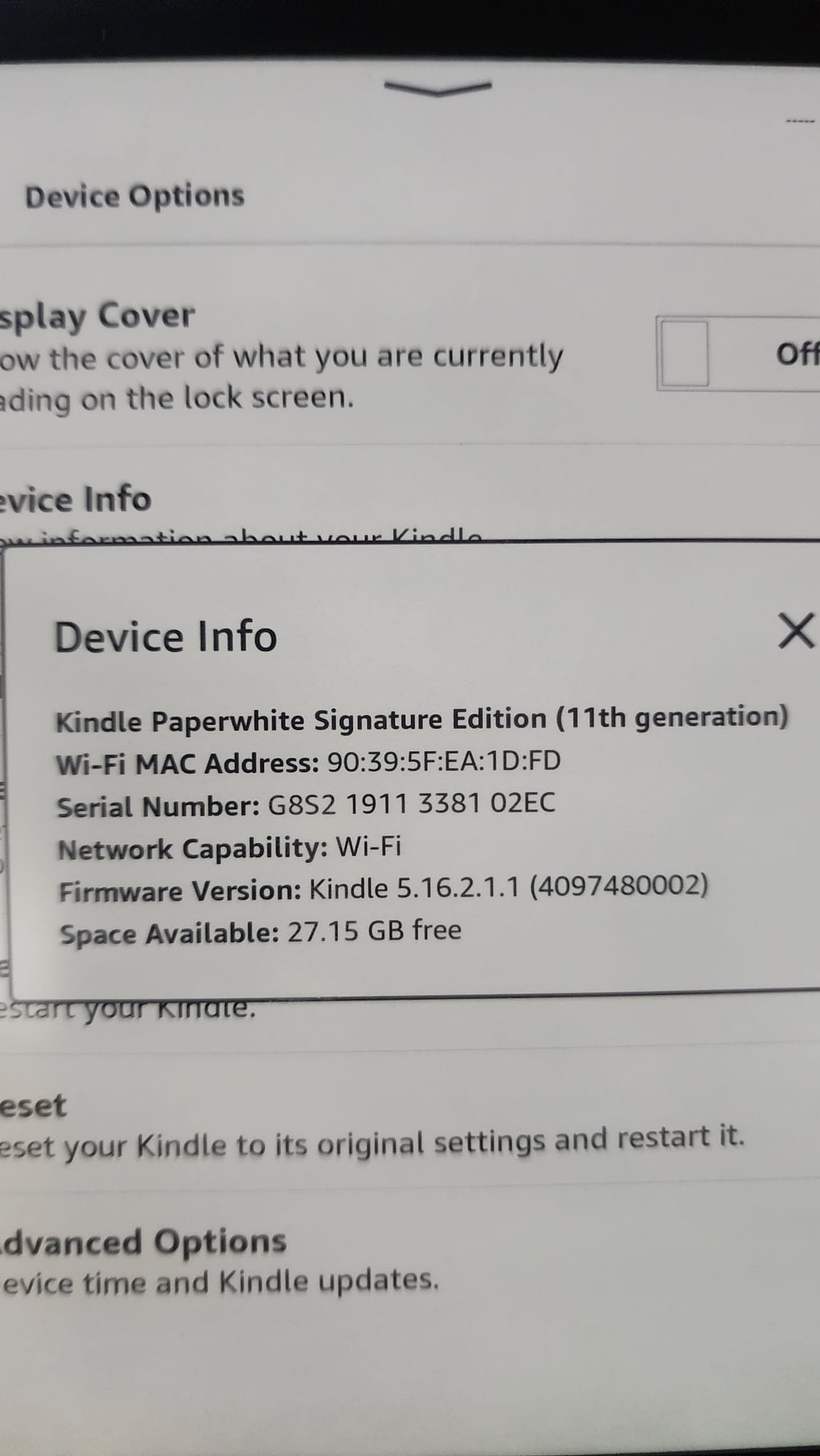

Facing the following issue. I'm using PW5 with 5.16.2.1.1 fw.

hoaka34 is offline   Reply With Quote

Hi,
I have the same issue with a new kindle paperwhite signature edition. I get a
"Not targeting your device, skipping" error when trying to install the latest kual coplate booklet through mrpi.
I alo can't find the serial codes for my kindle anywhere in any of the "what kindle do you have" lists btw. The serial starts with G8S2 1911
it's running 5.16.2.1.1 and I've installed the language JB and the hotfix from the language jailbreak package (the mkk subdirectory is there).
Thanks!

What’s your Kindle model? Storage, color?
This looks like denim (or other colors, plum?) version of a Kindle, or maybe Kids… (remembering eBay stuff)
Hi,
it's a kindle paperwhite signature edition 32GB denim. I've attached a photo the kindle device info..
just recently purchased from Amazon US as part of a black friday bundle sale..
Thanks!
Name:	kindle device info.jpg

Unless there is something fundamentally new, this should be a matter of adding your serial number to the packages.
NiLuJe, can I help you with this, using kindletool?

@bigwoof: I've just respun the *JB* hotfix in the snapshots (not KUAL, so you'll have to install KUAL via ;log mpri).
