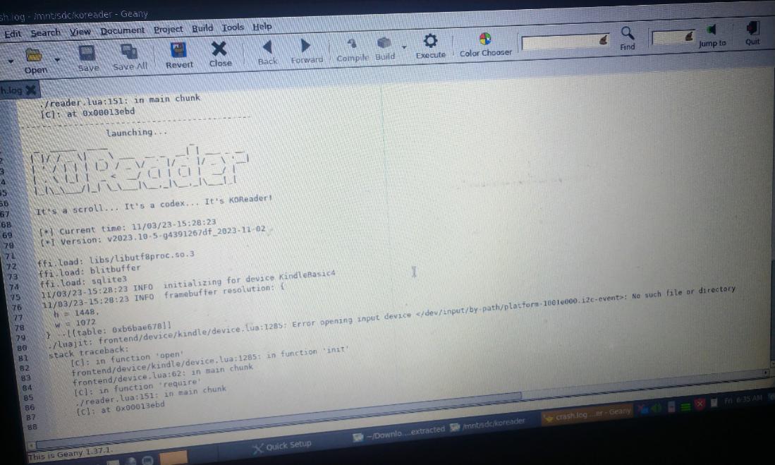

Originally Posted by QBit99 View Post
For some reason i'm still getting the same error even if the most recent nightly. Could it be because i'm using the "kindlepw2" version?
That picture crops out all the interesting bits, so I can't tell you anything more.
I tried to open KO 3 times so crash.log had 3 entries. On the picture is the last entry in full
