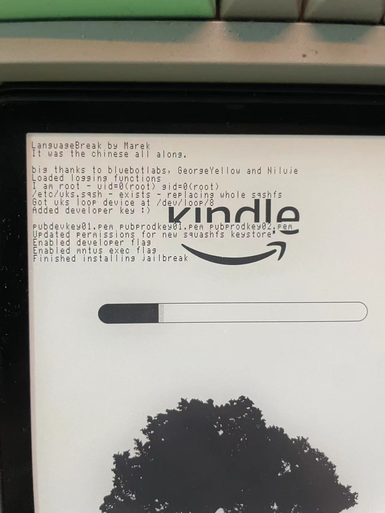

a632079
a632079 began at the beginning.
a632079's Avatar
Join Date: Aug 2023
Device: PW3, PW5
Thanks a lot for poster effort!
I am already already do jalibreak successfully in my KPW5 PW 5.15.1.1.
Last edited by issybird; 10-30-2023 at 07:27 AM. Reason: Oversize image attached as thumbnail. Please read the guidelines for limits on image size.
